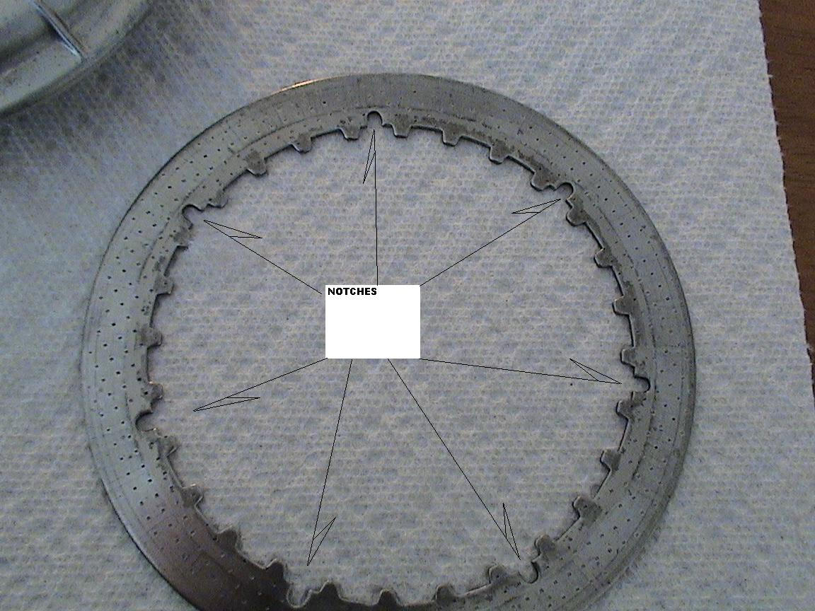

Post by brewsky » Mon Feb 15, 2010 7:14 pm
What are these notches for and does it matter how they are aligned?
All in line, or staggered?
To allow oil flow?

Post by LOUD MOUSE » Mon Feb 15, 2010 11:05 pm
They are to keep the plate fro warping.
No. ............lm

Post by brewsky » Tue Feb 16, 2010 12:09 pm
Thanks. Since I didn't notice them till I had taken them all off I was worried I might put them back wrong and screw something up.
