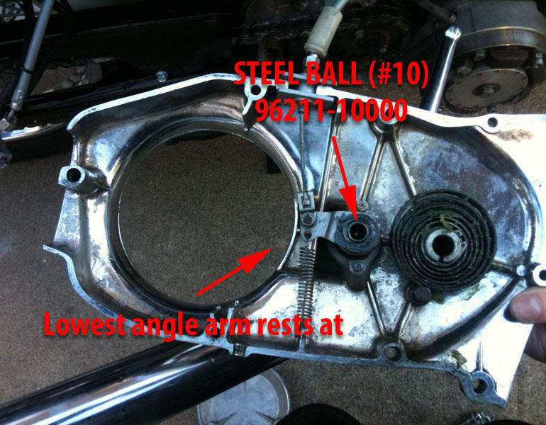

So I realized that the 10mm bearing that rests into the clutch adjuster was missing. I don't think there was ever one there. I called a few local Honda dealers and found one that had the part in (BALL, STEEL (#10) (5/16) 96211-10000).
I got home excited to see how well this would alleviate my shifting problems. Dropped the ball in, and hooked up the clutch cable, and slid her on.
The case won't close with the bearing in. It doesn't seem there's enough room for the clutch rod AND the bearing. This could be why there wasn't on in there in the first place. Odd right? Could this have something to do with a CL77 right crankcase on a CB77?

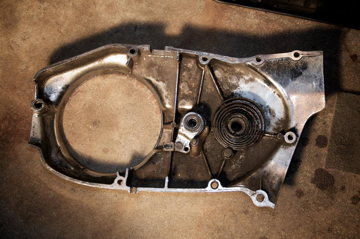

Here's a shot of the tension on the arm with the cable hooked in. The lever is easy as butter to pull in with the case off, and even with it "on", but gently screwed in. As soon as I tighten it all down is when it becomes very, very tight.
I've had two different clutch cables. The original which is too long (cleaned & lubed). I assume for the high bar variant. And a new one for the low bars from Charlie's Place. The cable from Charlie's was far too short. I tried routing it every way I could and would barely be able to hook it in. the arm was resting even higher with the "slack" adjusted on both ends.
