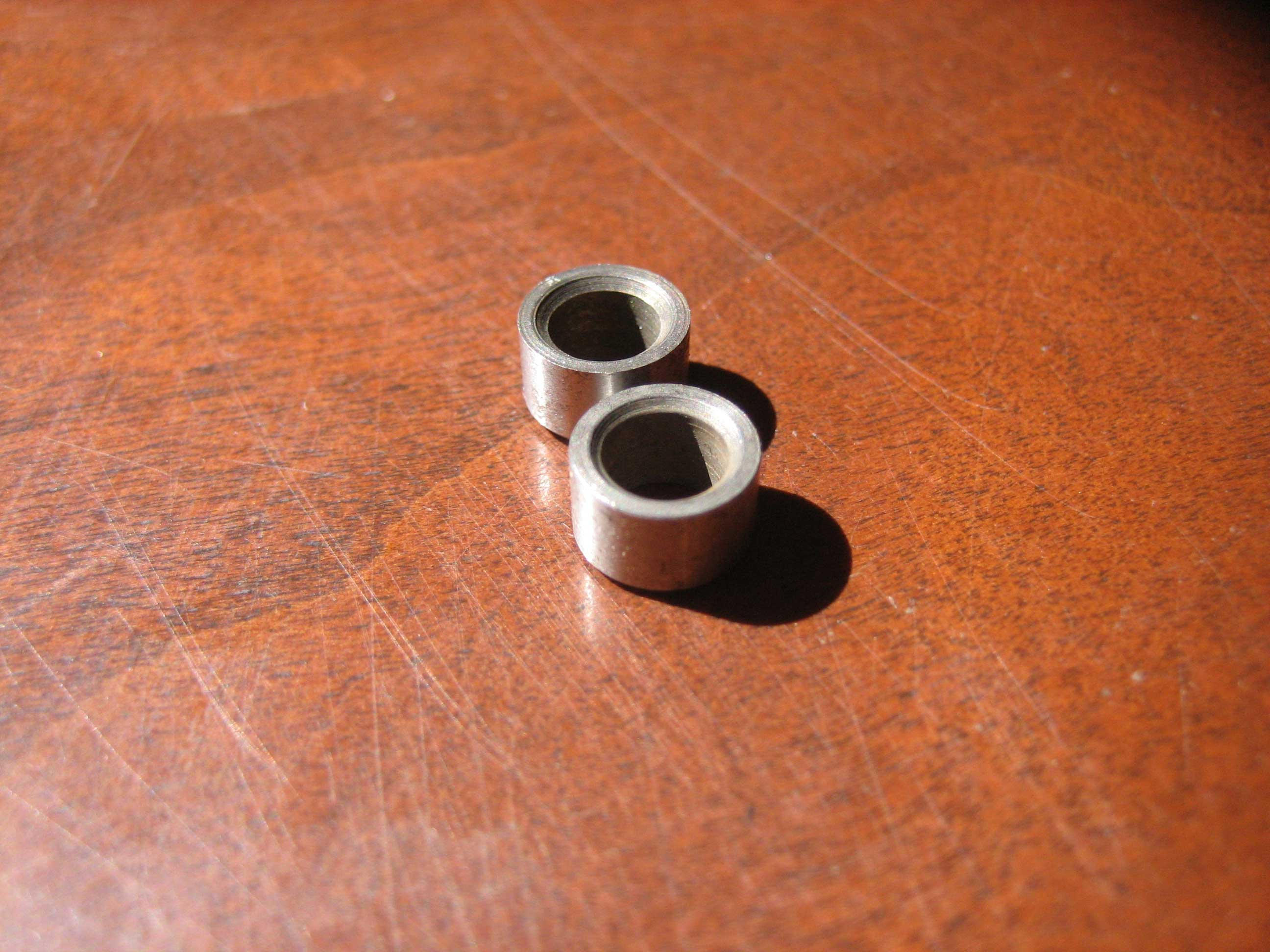

Which way do the shift fork rollers get placed into the shift drum?

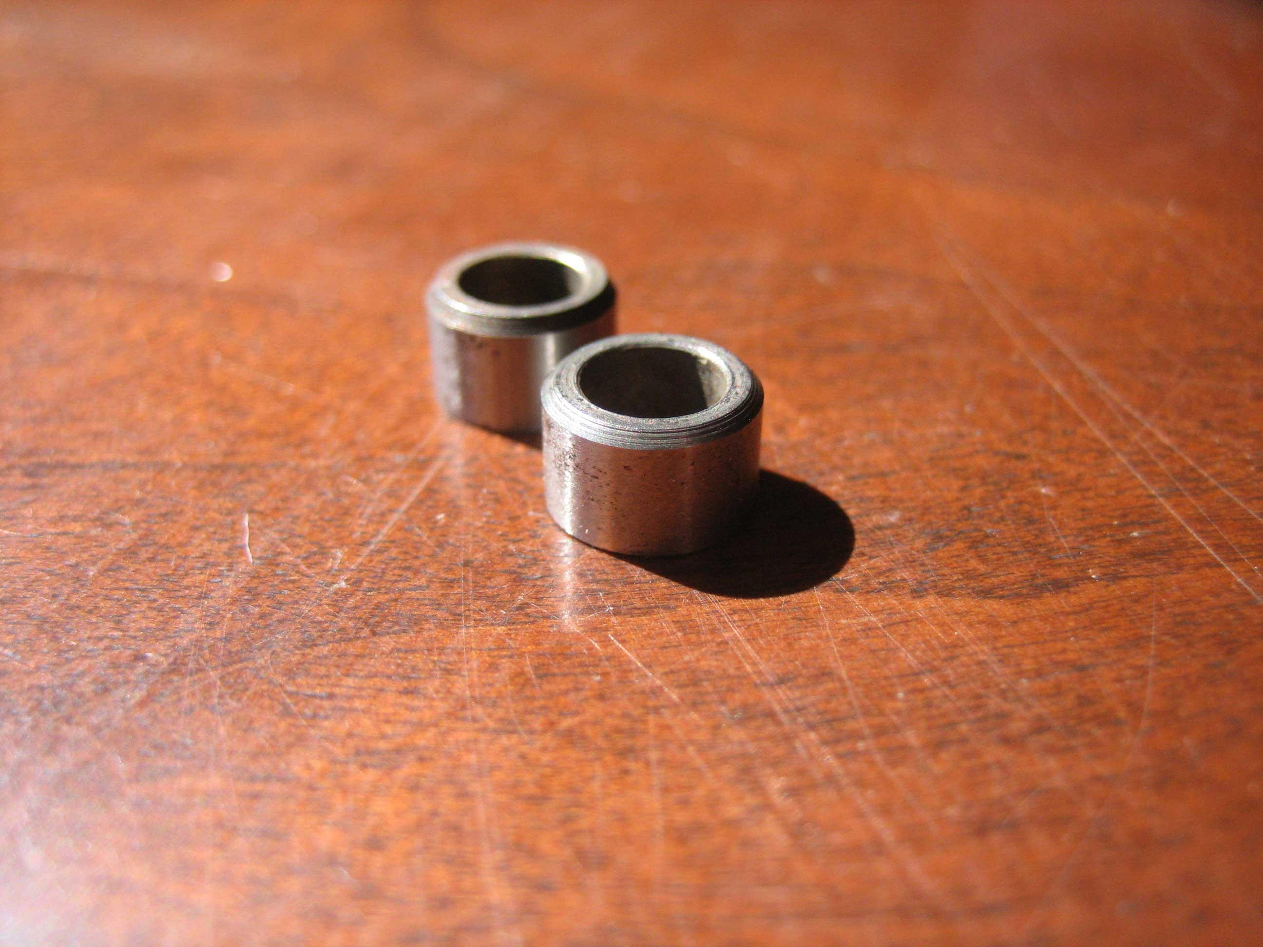

The ends of each roller are not identical: at one end there is an exterior bevel edge (photo 1) and at the other an interior beveled edge (photo 2) -- so, I imagine there is a right way and a wrong way to install them.
Is the end with the interior bevel (second photo) designed to accept the shoulder of the shift drum pin?

Yes. ..........lm
