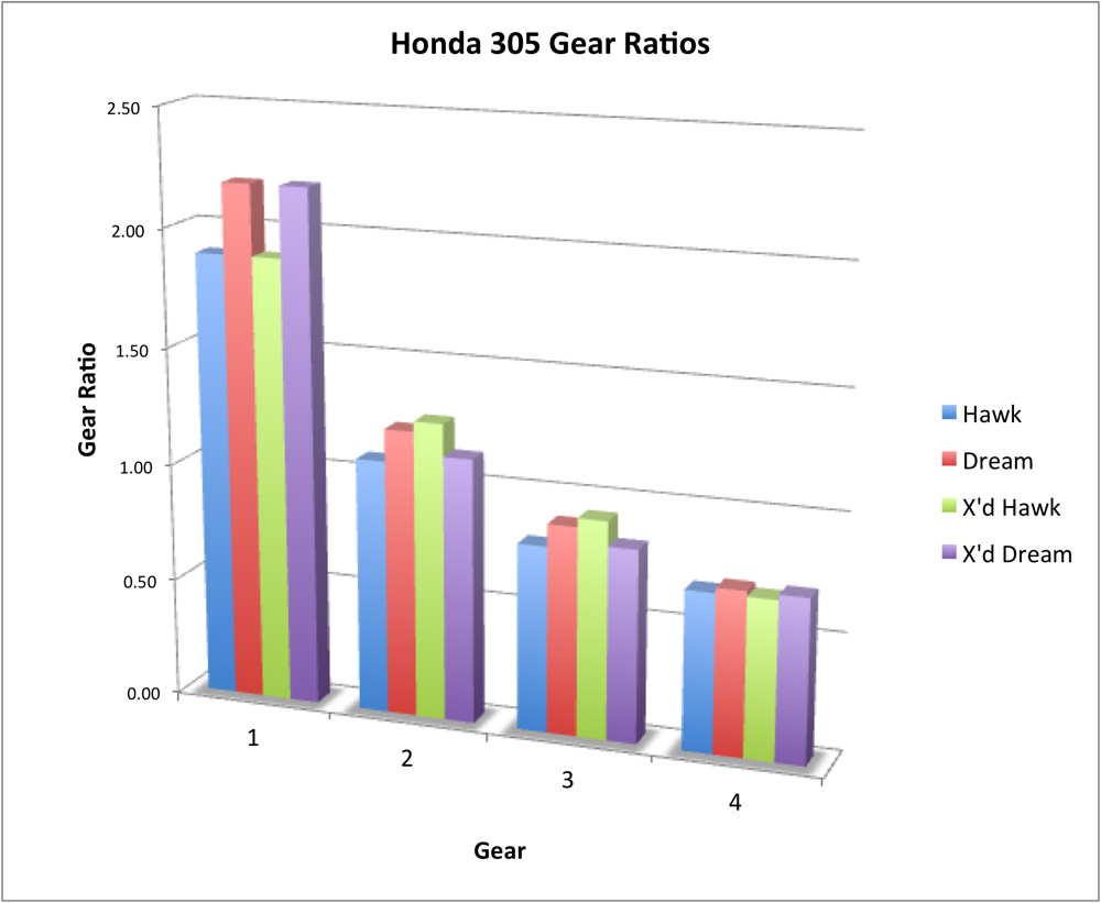

I have a ton of gearbox parts but no complete Hawk transmission that I know of. I did a spreadsheet of the gears in the parts manuals to see what I could build up for my CB77.
Here is a little graph of Hawk and Dream ratios (from the gear teeth numbers) and the comparison with X'ing them....
That Dream first gear is rather low but the others, whether X'd or not are much of a muchness. Has anyone mixed and matched Hawk and Dream transmission gears (as pairs) ?

G, Now I am starting to get a little confused. In my first post I noted the ratios for the Dream from the Shop Manual are:
Low 3.39
2nd 1.88
3rd 1.38
Top 1.00
The chart you posted shows ratios that look like they range from around 2 to .5. How do I interpret the difference? The chart would also appear to show "much of muchness" for Dream and Hawk gears whether X-ed or not. Do I have that correct?
I realize that there is also difference in 16 vs 18 inch tires as well as different sprocket ratios on the Dream vs Superhawk, which will translate into different RPM/MPH.
The one thing I think I do discern from your graph is that an X-ed Superhawk gives a much more even "line" across the top of the plotted gears, i.e. more even spacing between gears. The Dream - X-ed or not - seems to be much of muchness. Does your final question regard putting Superhawk 2nd/3rd, X-ed in a Dream? That would appear to get at what I have been suggesting, i.e. more even space between gears.
Is there something I am missing in what I think I am seeing in G's chart? I would really appreciate any help anyone is willing to give on this.

I assume that the ratios in the manual include the primary reduction and the final drive reduction. i.e. the total ration between crank revs and rear wheel revs. My graph is just the ration between input and output shaft of the gearbox determined from the teeth on the gears.
It's interesting (but not shown in the graph) that the Hawk and Dream have different pitch gears. The sum of the teeth on Hawk gear pairs is 52 while the sum on a Dream is 51. I have not checked but wonder if you can transfer gear pairs from bike to bike. i.e. could you use a Hawk first gear (pair) in a Dream.
Your observations are correct on the graph but the chart won't tell you what the result actually feels like on the road.
It looks like there might be some fun to be had with building up a gear set from the two different bikes. I'll have a look at the weekend.
