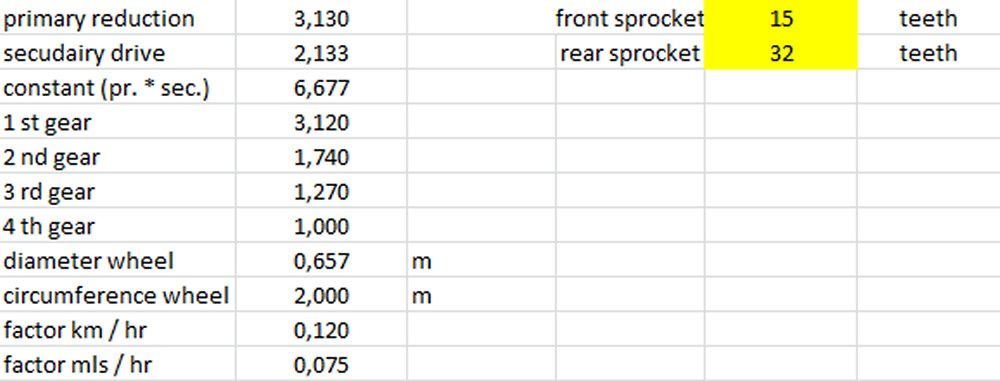

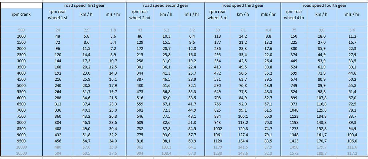

Post by jensey » Fri Oct 19, 2012 1:28 pm
Hi,
Thanks for the tips guys. I wonder how many riders thought they did the Ton in 1960, but didn't, because they didn't know their speedo was off by 10%.
10 % ? sometimes, but probably more !
With a secondary reduction of 15/32 this is the crank rpm versus the speed, calculated taking all reductions in account :
JSharpPhoto
Posts: 118
Joined: Wed Oct 17, 2012 11:41 pm
Location: Dallas, TX
Post by JSharpPhoto » Fri Oct 19, 2012 1:46 pm
thanks for that!
it looks like 15/32 is a good starting point.
