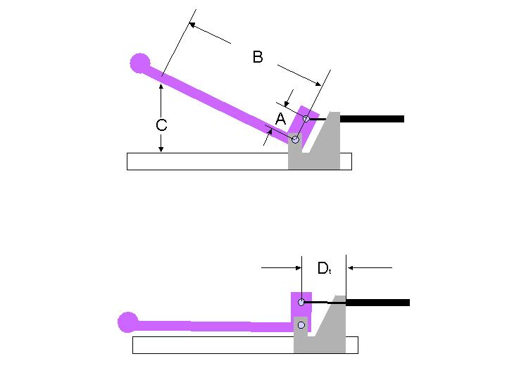

I believe what you are asking is how far does the cable travel from fully engaged to fully disengaged at the clutch lever. That is the key to the solution.
To understand what is going on, you really need to know is what is the distance from the pivot hole to the cable slug hole on OEM levers AND, what is the travel distance of the lever at a given distance from the pivot hole in addition to the cable travel distance above.
So, I went out and measured all this on my '67 CL and have provided it here in a diagram for you. Dimension B is arbitrarily selected due to the curvature of the lever. In this case, it is the point on the lever that touches the bar when the clutch is fully disengaged. You do need to maintain that same dimension if you are comparing another lever to an OEM lever, even it it does not touch the bar at that point. It is still the point where you measure lever travel.
The following measurements are taken with a lever free play set at 15mm.
A = 30mm
B = 130mm
C = 80mm
Dt = 17mm*
* - Note that Dt is the distance the cable traveled thru 80mm of lever travel, NOT the length of the free end of the cable protruding from cable sheath with the lever against the bar.

I only have about 1/2" travel (Dt dimension in Snakeoils diagram) on my CA, but it is enough to free the clutch.
Mine is also limited by having thicker than OEM grips and a slightly flattened lever.
