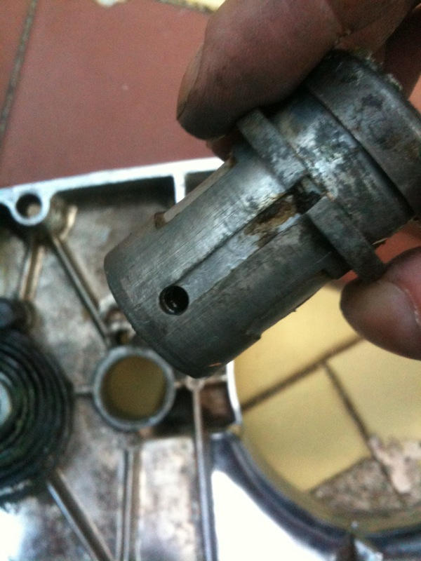

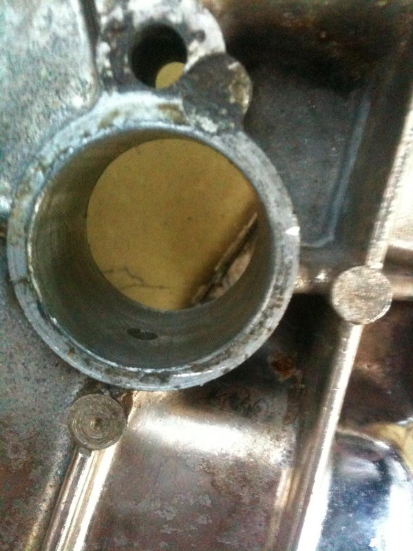

Post by Spargett » Wed Dec 09, 2009 8:20 pm
I have never been able to get the clutch adjust to move whatsoever. I ended up taking it off today and having to hammer it out it was so tight. No obvious reasons for it sticking. The metal was clean and smooth. Appeared to just be a poor fit somehow. I cleaned it up further, and lubed the outside with some assembly grease. Had to hammer it back in. Still just as impossible to move around.
I also noticed two corresponding holes inside of the adjuster that aligned with a grease nipple on the crankcase to lube the inside of the adjuster where the thread is housed. Which made me wonder, how could this work if one is turning the housing and un-aligning these grease ports?

You can see one of the holes here that leads to a grease nipple.
And the corresponding hole in the thread adjust body.

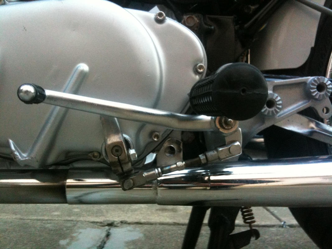

Post by Spargett » Wed Dec 09, 2009 9:03 pm
The biggest issue I'm really having is shifting with the shift lever. Lots of heavy clunky clicks when it is "working", and an incredibly hard time moving to second, which is simply impossible sometimes. I feel like I have the lever on at the right 11 'o clock position. But I just wanted to see if anyone sees anything wrong. Feeling more and more lost on this issue.
