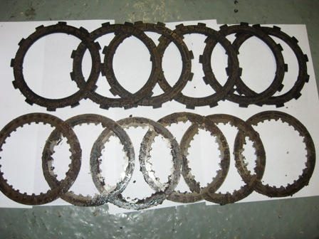

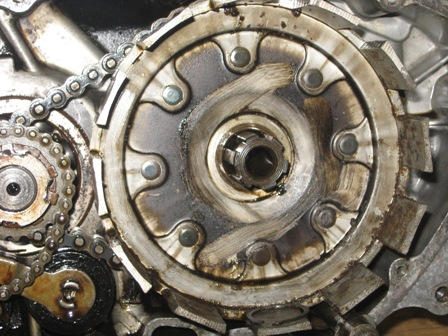

hello all, just removed my clutch of the cb72 and wondered if someone could help me out on what i need to purchase as ive read all the posts on clutches and im now totally stumped as yep youve guessed it ive found six friction plates (they seem to be made of a plasticky fiber type) and six metal plates, first ones are just over 3mm and the metal ones are 2mm thickness.
Any help would be much appretiated as ive fried my brain on this one.
Ps i just new my luck i would blooming well find six of each.
many thanks wayne aka danielmoto

Post by LOUD MOUSE » Sun Jan 15, 2012 3:34 pm
A while back I found a couple of the 6 plate clutch's. (have 3 wires)
Both were 1964 bikes.
One problem is that clutch doesn't have the THICK first plate which was used to keep the first plate from warping from heat.
The friction plates can be replaced with 6 of the 22201-MK2-000. ..........lm
