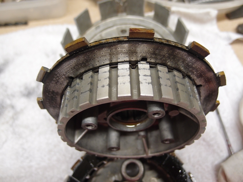

Post by auntyflossie » Wed Dec 24, 2014 5:47 am
Here is my Hub.
Thanks Martyn
Here is my Hub
Here is my Hub
CB77 Hub.jpg (194.18 KiB) Viewed 3064 times

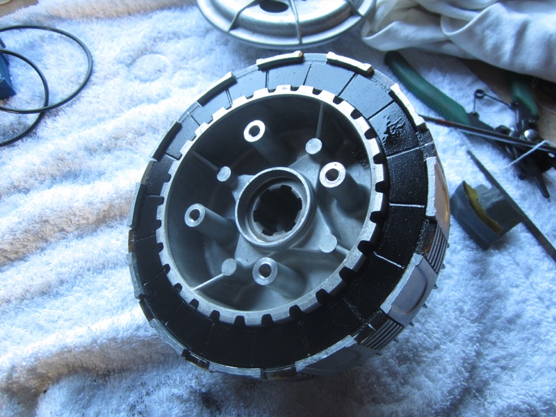

Post by auntyflossie » Wed Dec 24, 2014 5:49 am
With Plates in
CB77clutch 1.jpg (176.96 KiB) Viewed 3060 times

Post by LOUD MOUSE » Wed Dec 24, 2014 7:06 am
You have a Cush Drive.
I think you can clean it, oil it and use it. ...............lm
