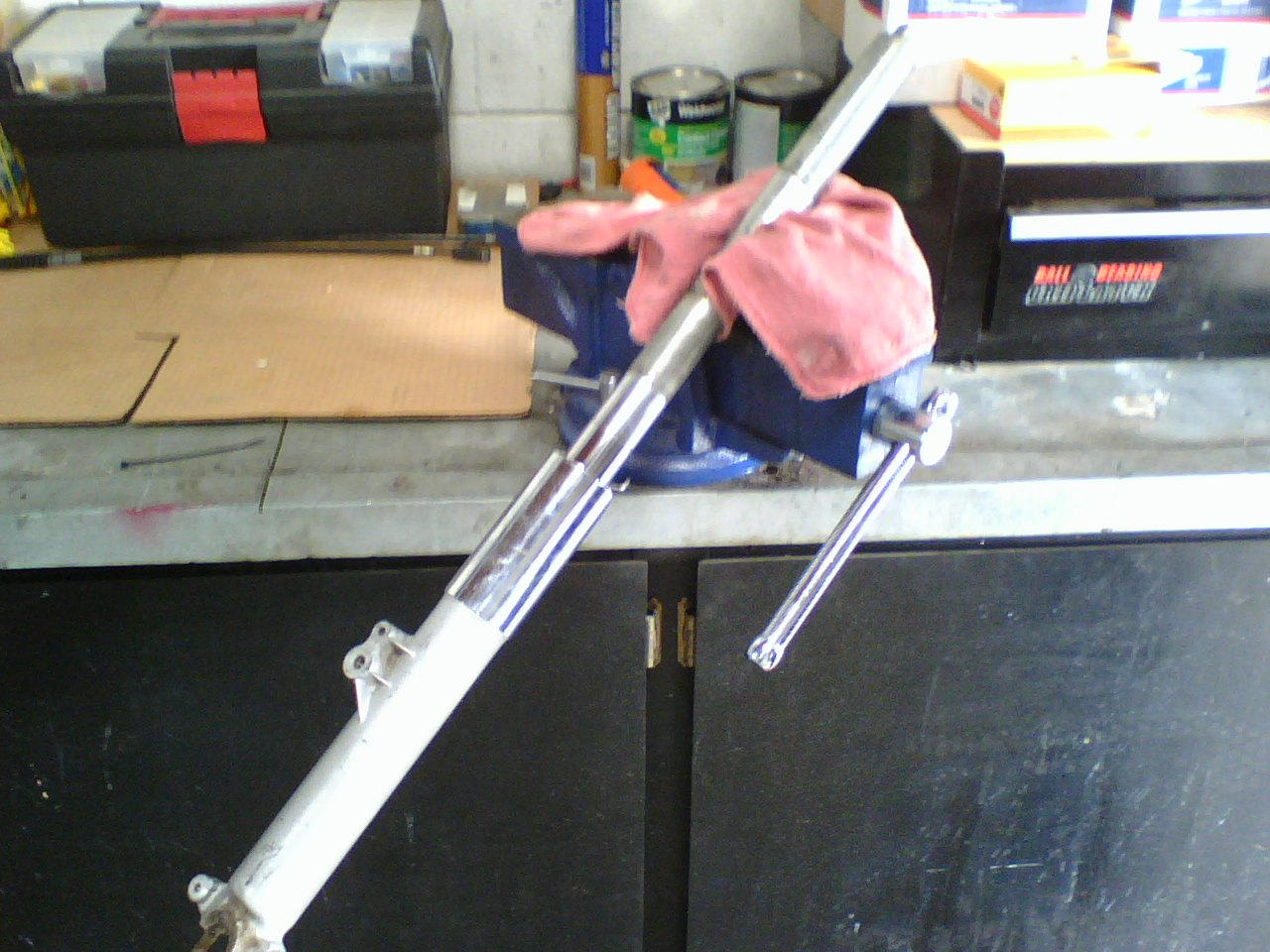

They are off the bike... and I have each leg pulled off now I can't get the chrome pieces off to remove the inner sliding piece...

Post by ggray » Mon Oct 15, 2007 2:51 pm
Are the holes in the seal housings good?
If so, a pin wrench (Spanner type) is best to use. I made my own. Also a strap wrench is useful to unscrew them. They are RH threads. You might have to clamp the slider in a vise but DO NOT clamp where the piston on the fork slides. Clamp at the axle mounting location so as not to damage the tube.
Use some good penetrating oil like KROIL and let it soak for a while before trying to unscrew them.
Havre you tried any of the above??????
Gary

The chrome pieces on mine don't have holes... I don't know if that means that they are screw on or press on? I was told to put the inner (steel) part in a vice and snap/pull it off but that doesn't seem to be working... heres a pic...
