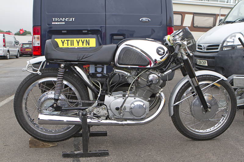

Posts: 5681
Post by G-Man » Sat Oct 11, 2014 3:06 pm
They look like standard CB72 forks. There are two lugs at the bottom of the stanchions and two mounts at the top on the inside.
A CB160 fender looks a lot like a works Honda component and mounts just on the top mount.
CB72 with_CYB_parts_fitted small.jpg (114.84 KiB) Viewed 4908 times

Post by Tunster » Sat Oct 11, 2014 3:15 pm
That looks great. Are the forks on mine original?
Posts: 5681
Post by G-Man » Sat Oct 11, 2014 3:20 pm
Yep, those lugs you see are the top mudguard brackets. The standard CB72 has stays which reach down to the lugs at the bottom.

Post by Tunster » Sat Oct 11, 2014 3:24 pm
Thanks g-man I thought so just wasn't 100%. If I keep them I think I may need to get some brackets made to tidy up the mudguard fitting. Luckily I know a good mate that could do that stuff.
