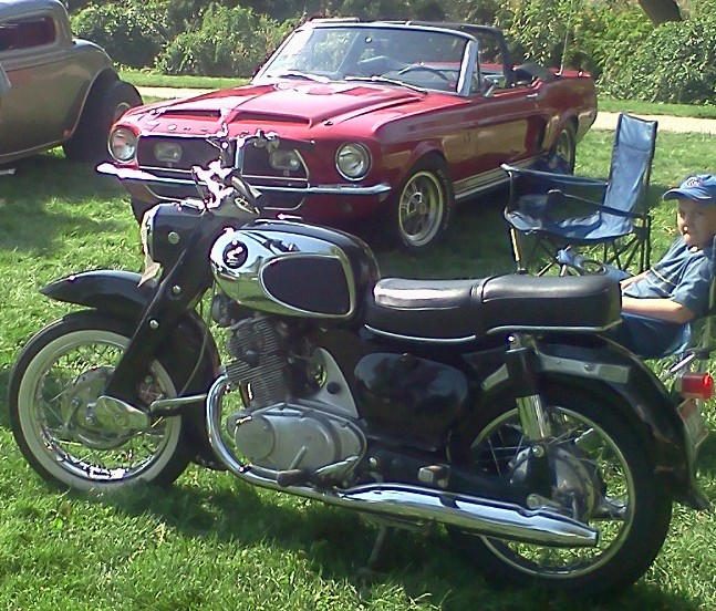

I have limited time and money for my bikes. I don't plan to follow the show circuit. I just want the best looking bikes I can get that I will ride a few times a week on shorter trips.
For my purposes, I like to keep things original whenever I can. It means living with some patina.
I have spent a LOT of hours with Flitz, rags and my rims. I even tried putting the whole wheel in a "tank" I made (top off of the salt tank of my water softener) with 3 gallons of Rust Dissolver. Chrome came out well with almost all of the rust gone. Aluminum hubs were very improved, too. None of my rims had a lot of rust to begin with, but there is some minor pitting. The spokes seemed to dull-up some from this treatment so I am not sure if I recommend it. But, getting the rim de-rusted on the tube side is worth something. Maybe I will try putting just the rim down in the Rust Dissolve instead of the whole wheel.
The main point here is that Flitz will do an amazing job at bringing chrome back, even when you have advanced surface rust. It will never fix a big pit or lifting chrome. But I have been amazed with about everything else. Even stubborn "bumps" of rust can be removed. It will usually leave a small pinhole, but most people will never get close enough to see it. It requires a lot of patience and lots of elbow grease. I find I normally have to treat an area 2-3 times on the rims. It gets better each time you put the Flitz on and let it work.
I have even used Flitz on those dull spokes. They are a little more time consuming and usually take 4-5 treatments each. But, most of my spokes came out as shiney as chrome. A few are more stubborn. Mostly, the difficult ones wore me out, but I plan to go back and hit them again this winter. You can get a lot done while watching a football game or movie. I saved an old electric toothbrush to get down in the tight spots.
The benefits are dramatically reduced cost ($20 for Flitz) and you have the original wheel with no dis-assembly/re-assembly/balancing. I also do this because it is therapeutic for me to bring something back to life that looked like it couldn't be done. I enjoy investing some of myself in my bikes. Below is the result.
Sorry for the grainy picture. I am no photographer.

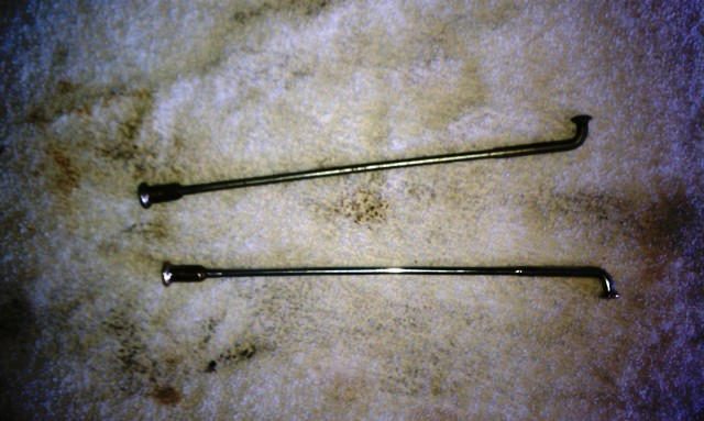

If you are going to take the wheel completely apart, instead of buying new spokes, you might want to try and polish the old steel spokes with a polishing wheel and ruge. I just completed a set and they came out like shiny stainless steel. Only takes 5 minutes or so per spoke and absolutely looks great. Will try to add a picture shortly to show the difference.

I suspect that now that the zinc plating is removed you will have very rusty spokes in the future. ......lm

Ricky, Please post a picture so we can see what they look like.

Post by Rickytic » Fri Sep 28, 2012 11:10 am
Hopefully the attached picture will do justice to the process.
