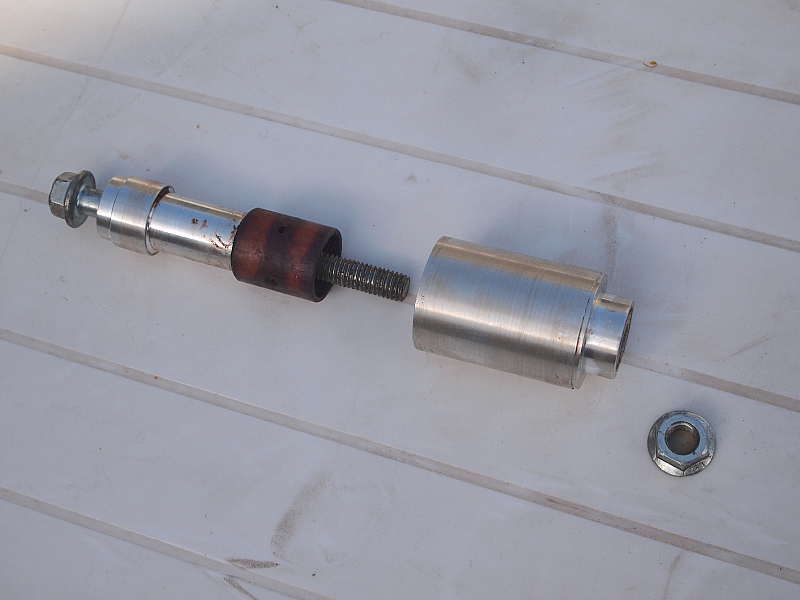

The fibre bushings are quite delicate but can be removed if you make up a special tool. The steel-backed rubber bushings need a heavier version of the same puller.

ummm so if i take the arm to a machine shop they should be able to press them out and back in or pull them out and press them in
does anyone make a replacement bushing???
Posts: 5681
Post by G-Man » Mon May 30, 2011 3:28 pm
The fibre bush is very fragile so you cannot just press it out as it will collapse. My tool is a close fit on the inside of the bush and supports it as it is being pulled out. A bronze bush would be a better replacement. If you get some made then you won't have to worry about damaging the original.
I'm going to make my own bushes when I put mine back together.

Post by wnbasac » Wed Jun 08, 2011 10:59 pm
i say this on ebay, ( Honda C95 C92 C77 C72 C50 C100 C200 BUSH CHANGER KIT
) will it work for removing the bushings?
http://cgi.ebay.com/ebaymotors/ws/eBayI ... _687wt_937

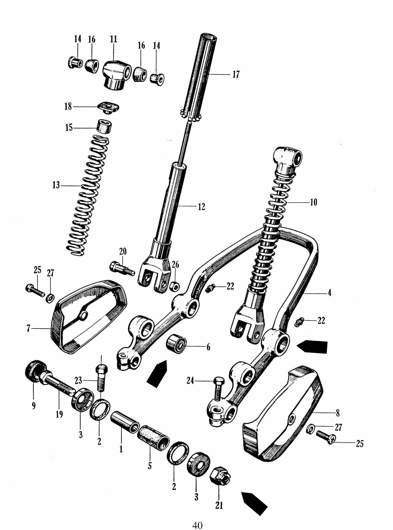

i'm still a little confused about the schematic showing the frt cushion breakdown
I already bought 2 ea. of the # 6 bushings and 2 ea. of items # 1,2,3,5 & 19
is that right or did i make a mistake???
ok i get bushings item # 6 but does the breakdown at the front of the picture go into the holes where the shocks bolt up?
