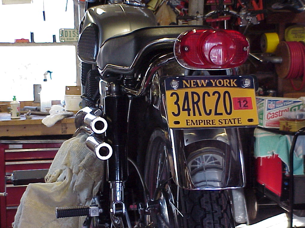

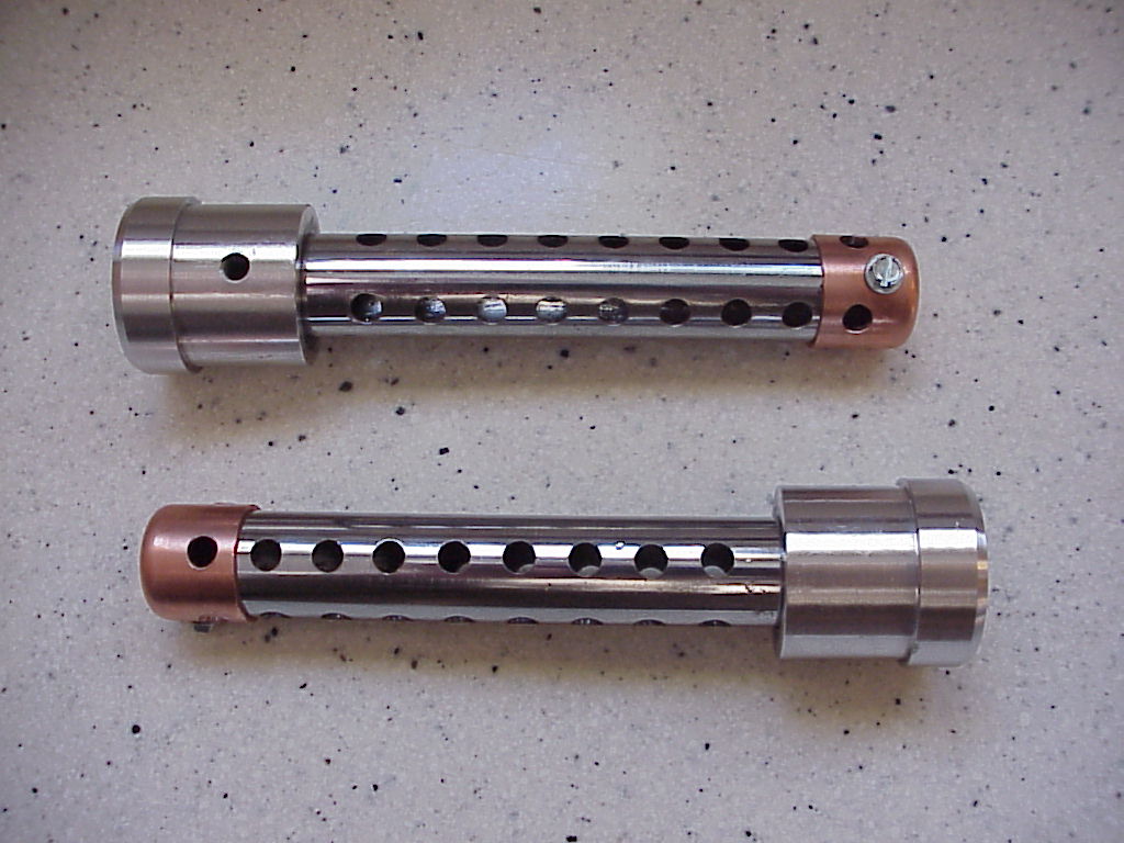

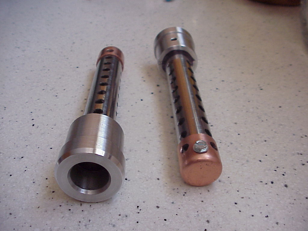

Attached is the final product. The baffle is a piece of 7/8" OD steel thin wall tubing I had in my stock, which was the handle for an old Toro electric snoblower I had thrown out. It's actuall chrome plated. I've used that handle tubing for a bunch of projects and this is yet another. The end cap is a simple 3/4" copper tubing end cap. 99 cents each. It is held in place with a self-tapping sheet metal screw.
The tubing was drilled with a 1/4 " bit at 1/2 inch intervals. there are 36 holes total. The exposed portion of the tubing is 5 inches long. I was not sure what the total area for the sum of the holes should be. So I figured the sum of their area should be at least the area of the ID of the exhaust pipe. For 1/4" holes, that came out to 31 holes. So, with 36, I figured I was okay.

I drilled new screw holes to keep the baffles in place on the back side of each pipe, 1/2 inch from the end and tapped the end caps to accept a stainless 6mm pan/socket head screw. This screw holds both the the perf tube to the alum end cap as well as the entire assembly to the pipe.

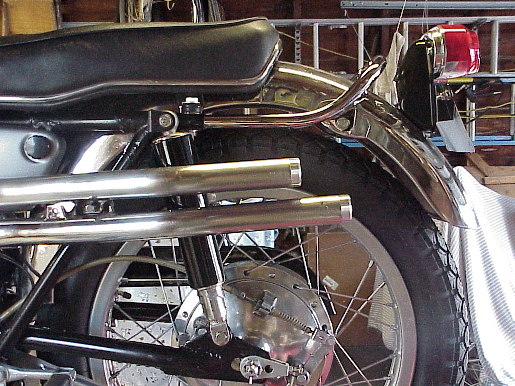

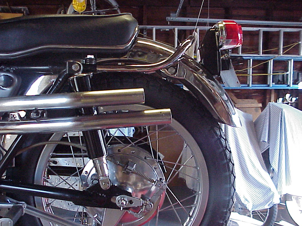

It sounds great. Maybe just a little louder than a stock Honda, but nothing like that gutted muffler sounded. Took the bike for a spin and did a plug chop on the way back and coasted into the driveway. Both plugs looked perfect with a nice tan color and a dash of carbon around end of the threaded portion. I had replaced the 160 mains that came in the bike when I got it last year with NOS 165 mains. Looks like my baffles emulate the same back pressure as the original muffler.
