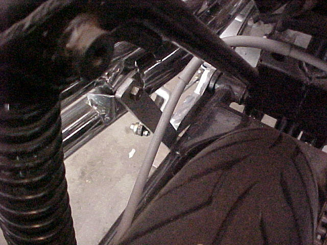

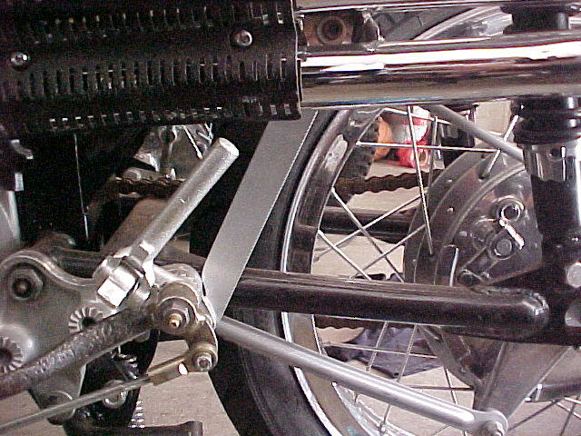

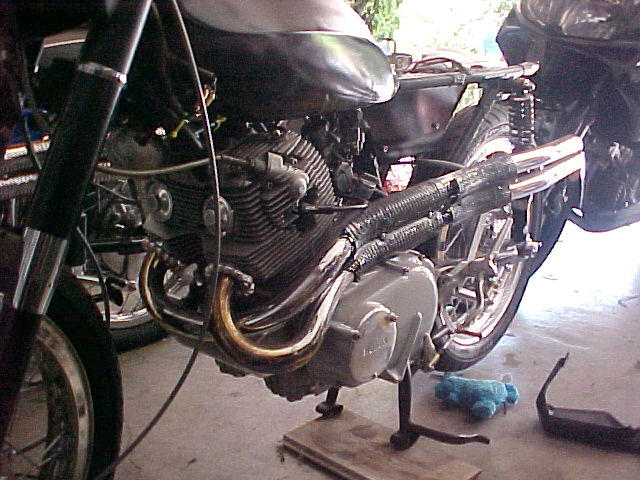

Has anyone mounted a set of CL pipes to a CB? From what I understand the stud spacing is different. Also, the flanges mount the pipe differently on each model. It looks like the best option is too drill the CL flanges to fit the CB head. Any thoughts or ideas? I want to change my exhaust to the high pipes. I already have a kickstand mounted and the centerstand removed.

They bolt right up to the head with the Scrambler collars. All you have to do is make a rear mount. Here's some pics of mine.
