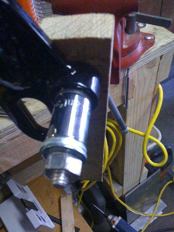

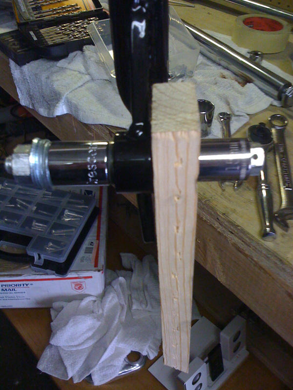

id thought i would share an easy way to get swingarm shock bushings in and out. i didnt take photos of taking them out but here are a few photos of putting them in. just drill a hole in a piece of wood, stick a bolt through it and use the proper
sockets and washer for spacing then tighten. the wood is so that you dont damage your nice new powdercoat. the process is pretty much the same on taking them out. shout out to doug for this great idea! hope this helps some of you.
