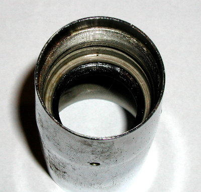

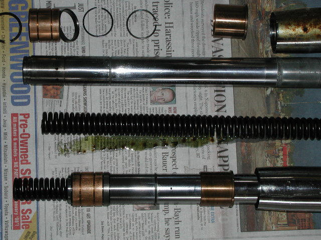

LM, thanks for your help but I'm still confused. When I took things apart I photographed the assembly because I was concerned that I'd have this problem. While parts were away getting painted and chromed I looked through the parts manual and bought 40.5 X 3 o rings (51522-268-000) along with a pile of other parts for the rest of the bike. I reassembled per the picture. I can't see where these rings fit. They're too big. The ID is more like 42 or 43 but it's hard to tell. Are they supposed to sit on the shoulder of the bronze piece? Was I sold the wrong parts?
Thanks,
Greg
Posts: 7817
Post by LOUD MOUSE » Wed May 27, 2009 8:37 pm
Just above the threads is a grove for the "O" ring. ................LM

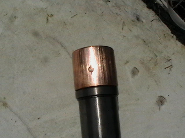

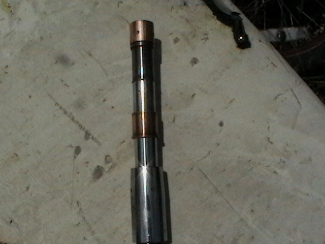

I need help!! I am trying to rebuild the front forks on my 1961 super hawk but ran into a problem when trying to disassemble. After looking at the pictures of the fork gac123 posted it looks different than mine. I need to get the brass bushing off the bottom to remove the seal retainer but it looks like I need to remove four knock pins holding it on. These pins have to be removed by knocking out from the inside of the tube??? Not a clue as to how I will do that. Also the brass is peened / staked in to make it more difficult. Has anyone out there done this style fork? I have an e-mail sent to LM hope he returns message. Some pictures.
