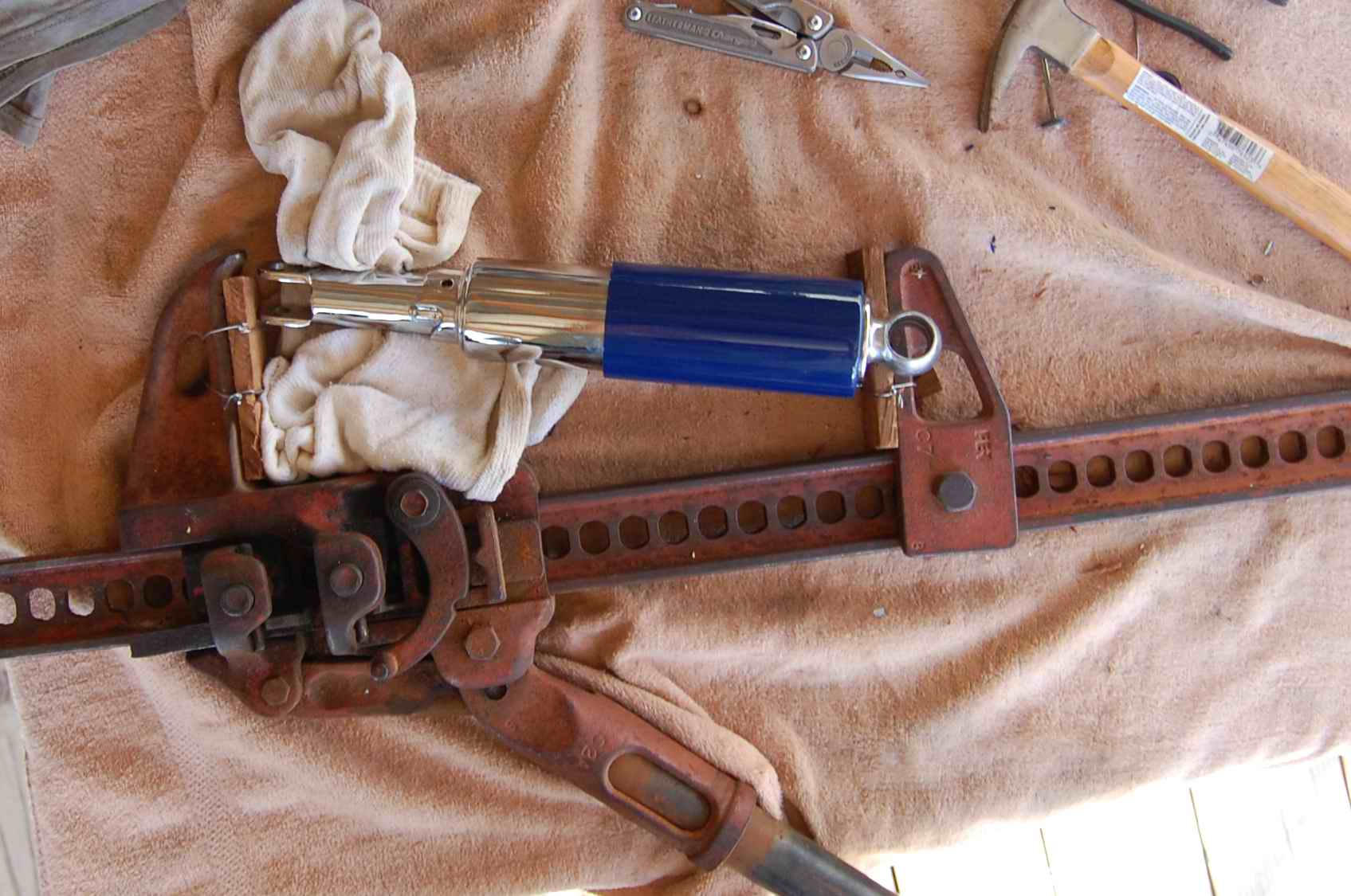

jleewebb
- Posts: 472
- Location: travis county, tx
Post
by jleewebb » Fri Mar 06, 2009 10:27 pm
I managed to get my beautiful new shocks assembled with my trusty tractor jack. Not recommended, not easy, nerve wracking, but I managed. There were a number of posts a while back on doing this with various spring compressors that can be rented, somebody managed with a work-mate. Might be worth a search. My restoration thread has pic of practicing on old shock when I thought they might be salvageable. There's also some info on my adventures with disassembling front forks that might be helpful. Good luck, Lee

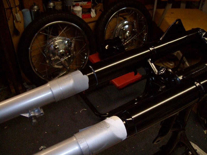

Gunner_CAF
- Posts: 316
- Location: Wisconsin, USA
Post
by Gunner_CAF » Sat Mar 07, 2009 12:10 pm
Spargett wrote:Thanks guys for all the info. As much as I really want to paint those sleeves. I just don't think I'm set up to use hydraulic presses for disassembly/assembly. Maybe there's a way I can tape them up and still get it painted reasonably well.
I painted my front forks without removing them. Your frame is stripped down the same as mine right now. I just tipped the frame back so the forks were horizontal and masked off the parts I didn't want painted. It actual made a nice stand for painting. I have a picture of this in my other post.
Gunner
Gunner_CAF
- Posts: 316
Post
by Gunner_CAF » Sat Mar 07, 2009 12:35 pm
Here's a picture and how I did it. I tipped the bike back on the frame and covered the base with plastic (not in picture). I masked the top , the chrome trim ring, the steering lock, the Honda Motors plate on the frame and the frame number, the steering tensioner on the bottom. I wrapped the center chrome sleeve in computer paper and slid it under the outer sleeve.
I did the lower aluminum first, then covered these with plastic bags after they dried. then did the black. It wasn't hard to paint this way, it just took time to mask it off.
