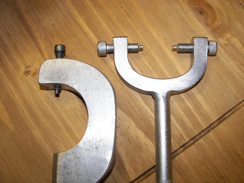

I use a wrench (1/2 inch aluminum) I made that is a single pin type and shaped like the HONDA shock adjuster wrench.
I made it so the arch is the size of the round on the seal holder and then drilled and tapped to the threads of the hex screws that are sold to replace the ones on the engine side cases then ground the end to a size that fits into the holes in the chrome seal holders. Works every time. ............lm

Post by LOUD MOUSE » Sat Sep 08, 2007 8:53 pm
One of these is a HONDA tool. ..........lm

Post by cribbs74 » Mon Sep 10, 2007 7:51 am
LM........Are those tools for the steel sliders or aluminum? I am guessing the steel ones. I think I have the aluminum ones as the seal cover screws in from the top with the pin holes on the top as well. I'm learning more every day.........ggray sold me his for less than I could make it myself. I'll post how things turn out. Good pic, thanks
