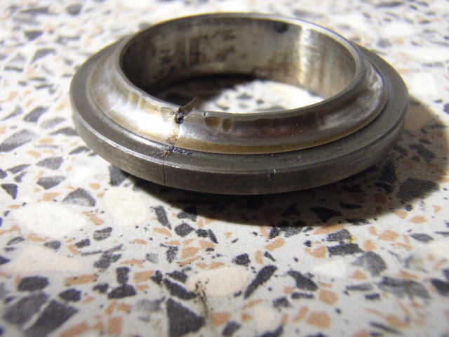

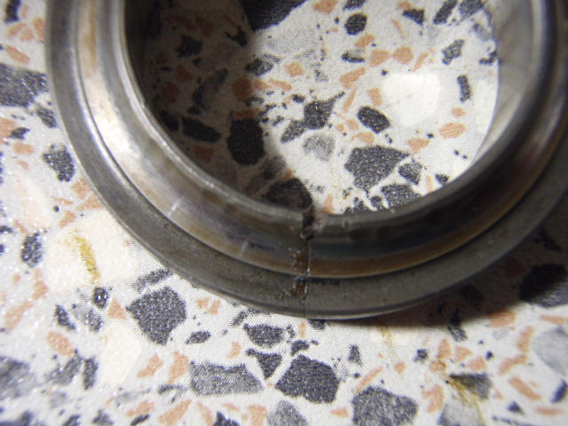

By the way, if one part a a given bearing is not up to it's specifications, the part where with it interacts is also not within specifications. Never try to replace only the balls,, you're fooling yourself, doinig a lot of work and don't fix the problem.
After 100.000 km I replaced the bearing of my CB400F, it was steering bad, so decided to start this winter with the front end (steering, forks, wheel bearings, etc).
This was the reason for bad steering behavior :
Yes that sounds correct.

Yes, I was in denial about my races. I thought I could get away with the cheaper solution. When I put it back together it was lumpy and bumpy. Once I took a close inspection of the races which seem relatively intact, they showed some damaged areas. Although, they didn't quite look as bad as yours!! Thanks for the advice!jensen wrote:Hi,
