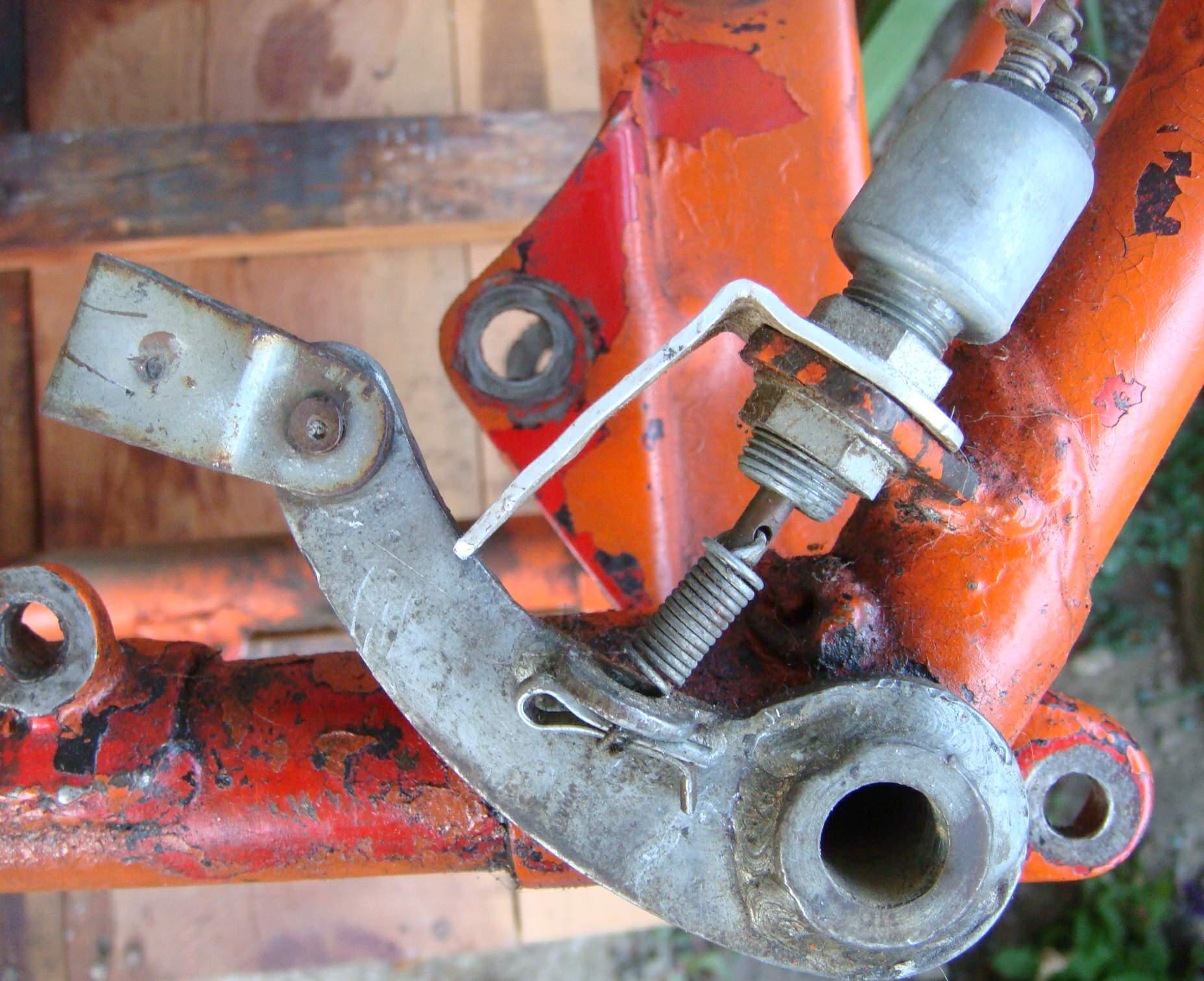

my CL72 has a nifty little homemade stopper that stops it from retuning too far... !?!?!?
you can see the condition of my frame, I have finally gotten everything off, except the stop switch and the brake lever !

Post by LOUD MOUSE » Mon Aug 25, 2008 8:39 pm
Wrong switch. .................lm
