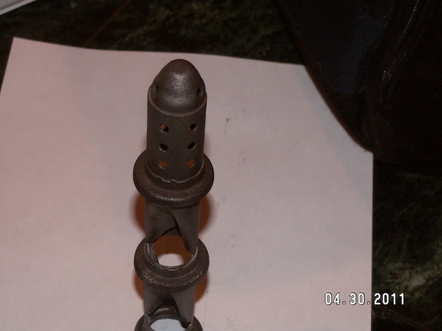

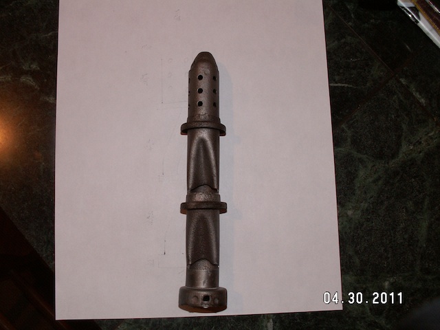

There are 2 holes in the tapered cap. They are about 120 degrees apart and face the outside of the bike.
There are 18 holes in the cylindrical part.
The holes are about 1/8 inch realizing that they are really metric. The bolt hole at the tail is a little larger. I can get the thread measurement next week but we can put any small sturdy bolt there.
The pictures show the outside and inside of the device. The cylindrical parts slide into the washer looking pieces and are tack welded.
George
You can see the hole in the tail and the two nose holes

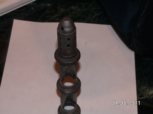

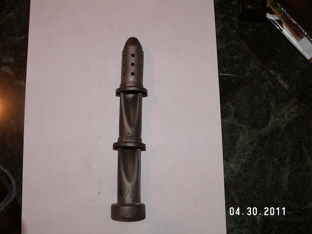

Post by geosar » Sun May 08, 2011 12:04 pm
Two more photos.
You can see sort of, the holes in the tip. I am sure the exact location is not critical. There are definitely 2 facing the same side the anchor hole is.
George
