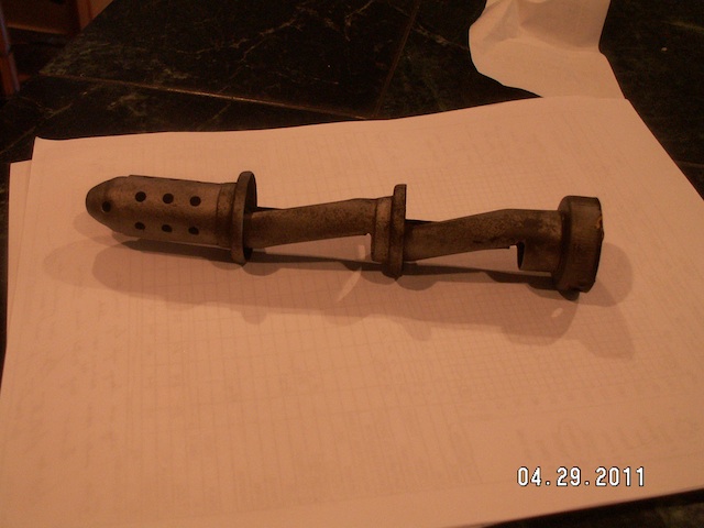

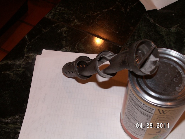

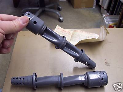

Here is one example of the Honda baffles.
Seems like they had two styles. One had a end cap and one had a open end with a pin.

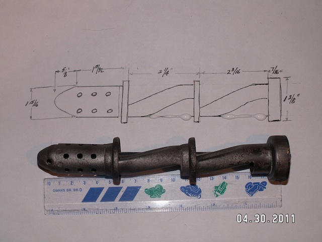

Thanks for posting those, George. They are actually pretty easy to make if you had the inkling. You could probably use washers of the correct OD and ID (gotta get lucky though on sizing) for the support collars and then just a hack saw and a hammer and punch for the offset baffles. Last bit it a drilling exersize. You could simple crush the end of the tubing and get the same effect as that closed end. I think the pin across the back end is simply to facilitate a handle for removal.
I'm happy with my baffles. But I am curious about how well these OEM baffles work at bringing down the dB. George, if you get some free time, could you please put some dimensions to those baffles? Tubing ID and OD, lengths of the various sections, etc. If you are willing to do this, I'd be glad to make a digital sketch and send it to you and you could just fill in the dimensions on the sketch. We could post it here in case others would like to try and make their own.
