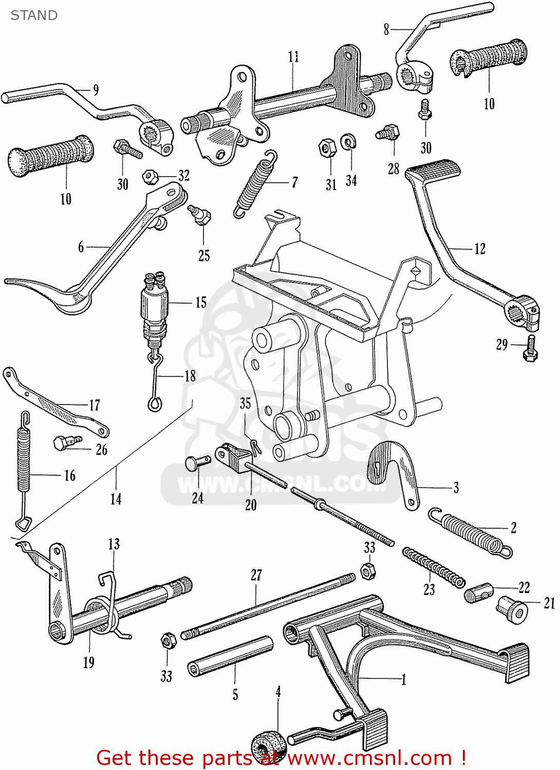

A couple of photos might help if you can provide? Is it possible that you have the rear brake, the linkage and the pedal adjusted incorrectly - it is a tricky set-up?
On my C72, the rear brake is well clear of the header pipe and the upper stop position of the brake pedal is defined by the frames foot-peg mounting bar (No. 11 below). All this means that a reasonable amount of preload is needed on the 2 springs that make up the entire assembly.
When this is all right, the position of an undamaged brake pedal is very comfortable.
Hope this helps.

As it turns out I think the lever itself is set up correctly at the correct height.
I think the problem was that I had the "play" amount set too low with about 2 inches of travel.
After setting rear nut for a 1 inch play everything is feeling much more comfortable and confidence inspiring.
