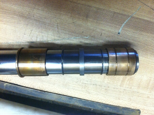

I am putting the front forks back together and I can't remember if this is the right order of things. Do I have the tube components in the right order?
Also, there is a beveled side of the silver ring. Does it face up or down?
66 cb77
Hope the pic works!!
Ian

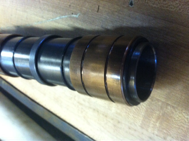

Here is another view

The steel ring fits above the lower bush with the flat circlip above it.

Thanks- and does the orientation of the steel ring's bevel matter?

The bevel does matter but I cannot recollect which way it goes.
Down, I think as the flat upper face then rests agains the flat circlip.....
Post by LOUD MOUSE » Sun Jun 22, 2014 6:58 am
You are correct. ...........lm
G-Man wrote:The bevel does matter but I cannot recollect which way it goes.
