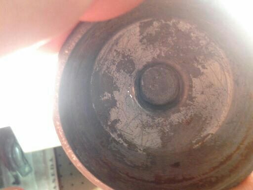

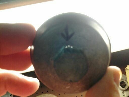

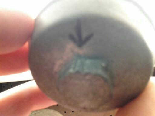

Hi everyone,
I'm having a problem with my '63 CA77 Petcock.
The bowl has some holes in a couple of places adjacent to the nut on the bottom.
They're not really visible unless backlit.
Here's some photos.
Any suggestions for dealing with this? Anybody have a spare bowl they'd be willing to part with, or a good sealer recommendation?
Re: Petcock bowl leaks....
Post by LOUD MOUSE » Fri Jun 15, 2012 1:20 am
J.B.Weld will fix it. ...........lm

Post by Captain Fantastic » Fri Jun 15, 2012 10:10 am
Thanks!! I don't know why, but JBWeld never crossed my mind. UGH!!
I'll smoosh some into the hole and smear a little on the inside and a little on the outside, do you think?

Smooshing is not very high tech. I'd ram some in there and slather it around.

Post by LOUD MOUSE » Fri Jun 15, 2012 4:13 pm
As it always goes to level all ya need to do is put enough to fill the casting hole and leave it alone overnight. ..........lm
