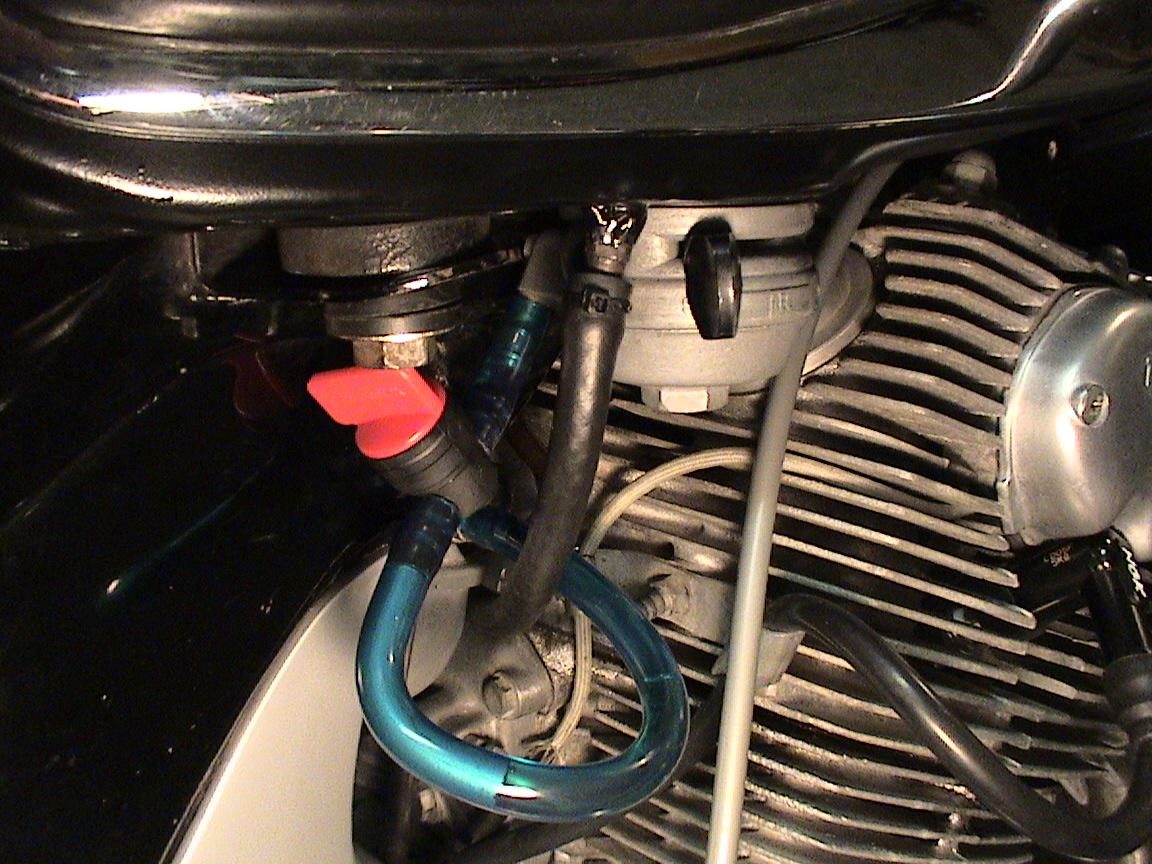

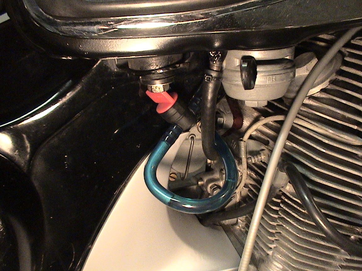

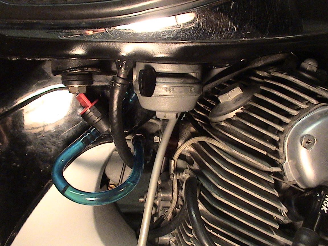

Not stock, but my solution so far:
Got tired of the aftermarket fuel filter interfering with the flow, so I replaced it with a small engine on/off valve to cure the ever recurring slow petcock leak.
All different fuel lines I tried kinked when they were bent into place unless a long loop was left in the line. So I tried inserting a pre-bent 1/4"OD metal brake line inside the blue tint 1/4" ID fuel line and voila!
Now to pre-bend more of a U shape to shrink the loop some more.
A tubing bender is highly recommended.

Post by brewsky » Mon Mar 26, 2012 4:55 am
I've rebuilt the petcock 2 or 3 times, using both the cork and rubber type gaskets, but every time I eventually get a slow drip thru the petcock when it is turned off. (It doesn't leak to the outside). It eventually overfills the bowl after sitting for some time, getting by the float valve and leaking out of the carb.
I think the cause is a slight bit of corrosion on the sliding lever around the holes. I cleaned it up and buffed it, but some small pitting remained.
