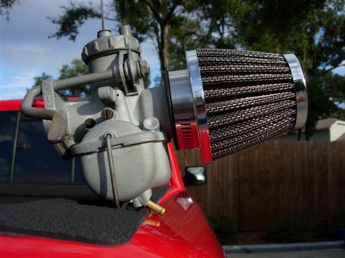

I have a 1962 Dream 305 and I just bought a new rubber air filter hose because the one I had was cracked and split. The new one doesn't fit. It's too short by about a half inch. I don't know if they sent the wrong part - or did the '62's use one from a different model? I'm going to return it, but I'm not sure what to order. I saw this on ebay. Anyone use one of these filters that attach directly to the carb?

The one in the picture above will work but they don't filter all that well. I use a Uni foam sock filter on mine. Once its installed you don't even really know its there.

I use one of those Unis on my Dream too. Works swell. You could probably just put it directly onto the carb but I ended up putting it on with the tapered rubber tube. It might not make much difference but I'm sure that tube has a little bit of a venturi effect.

I ended up using the uni pod as well, but recessed it from the carb with a piece of radiator hose:

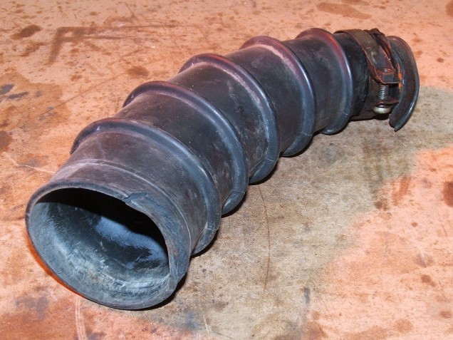

Was it used? Sometimes the ends where the clamps sit rip off pretty clean leaving you a 1/2-inch too short... Check the picture - There should be a relief on both ends where the clamp sits. You can see that one is about to lose its 1/2"
Those are hard to find in good condition or NOS. There's a reproduction on ebay from Thailand that may be OK (maybe that's the one you ordered?). They do come up used in decent shape from time to time on ebay, but look carefully.
