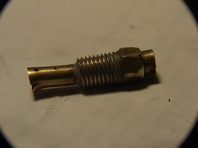

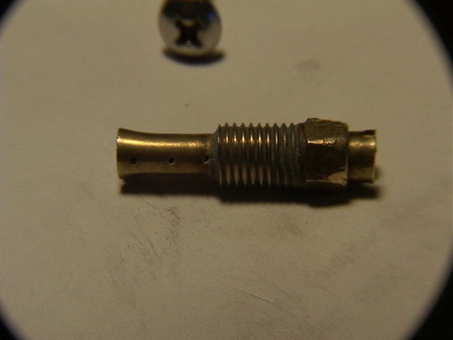

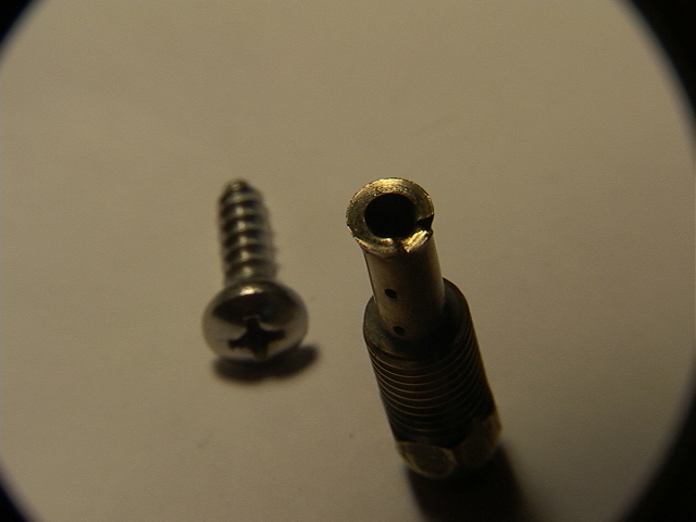

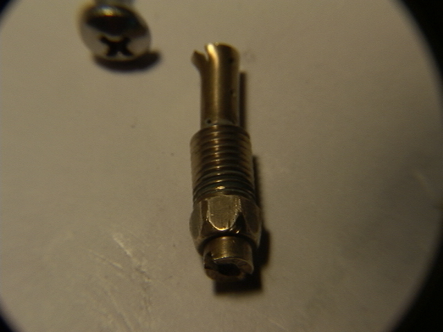

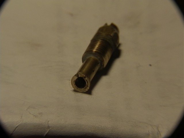

the shaft part (touches needle jet) is crushed and cracked. It's pretty bad, i'll get a pic today. The hole is completely shut but yea i can reopen it. The problem is, since its out of shape the needle doesn't slide in easily so the throttle slide will stay open

Oh my. That is junk. How hard did someone try to tighten that poor little part?
I'm sure that a CB72 part is shorter than the 77 but I don't have one here to compare. But if push comes to shove it might be possible to modify a CB77 part. The cross holes (bleeds) are different according to the manual but the carb is not on a CB72, so who knows how well or badly it will work.
If all you can get is CB77, get one, compare it and try it if it fits. It's not too expensive. That's what I do and it's why I have some interesting cross breeds and some parts I'll never use.
