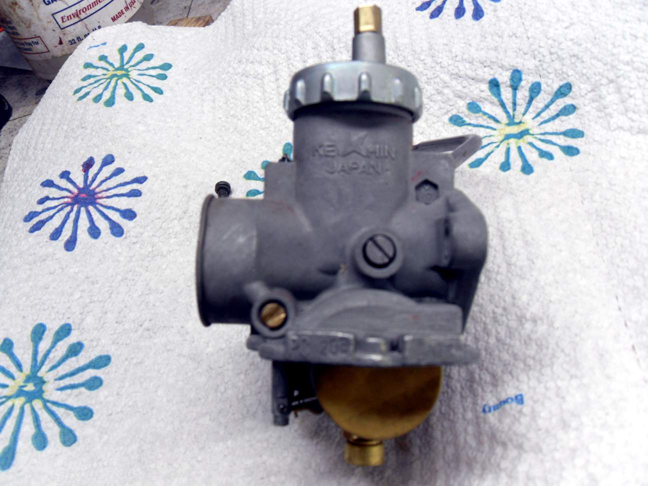

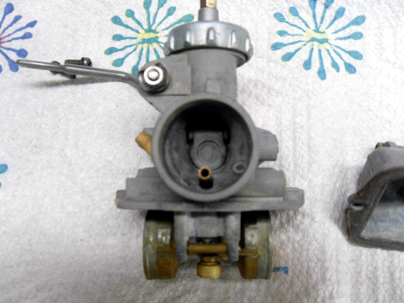

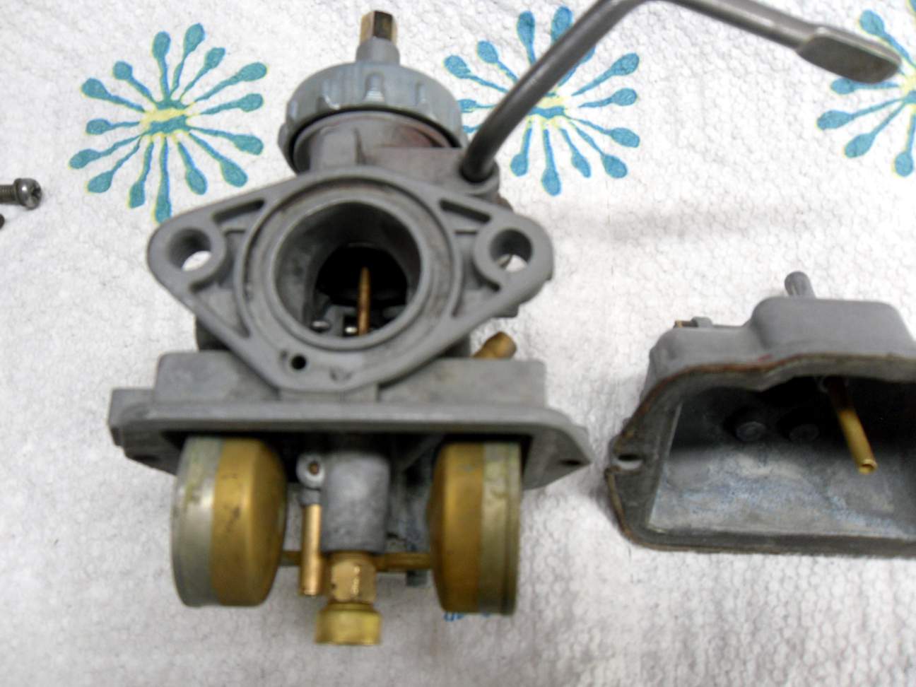

Post by cadman » Mon Apr 20, 2015 12:52 pm
Okay here's pics of the carb - PC20B - also has an o-ring float bowl. Maybe from a 70.
Post by LOUD MOUSE » Mon Apr 20, 2015 1:00 pm
I'm not so sure this is for a DREAM.
You say PC20 and the DREAM had.has PW22 carb.
Maybe others may know. ..........lm
cadman wrote:Okay here's pics of the carb - PC20B - also has an o-ring float bowl. Maybe from a 70.
Hoosier Tom
Posts: 817
Location: Logansport, IN
Post by Hoosier Tom » Mon Apr 20, 2015 2:35 pm
That's not a Dream carb as Ed noted. I think what you have was used in the small singles, like the XR70/80.
