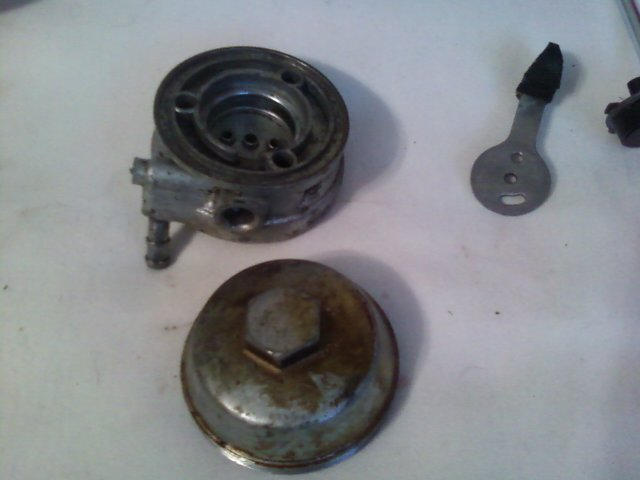

On my Kawasaki forum I know a bunch of guys that like to soak their crusty carbs in pine-sol over night and from what I see they come out beautiful and it supposedly it doesn't effect the rubber parts.
I have the petcock apart and have cleaned it with carb cleaner before rebuilding it but I'm thinking that it could benefit from a good soaking in Pine-sol first.
What do you do ?

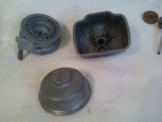

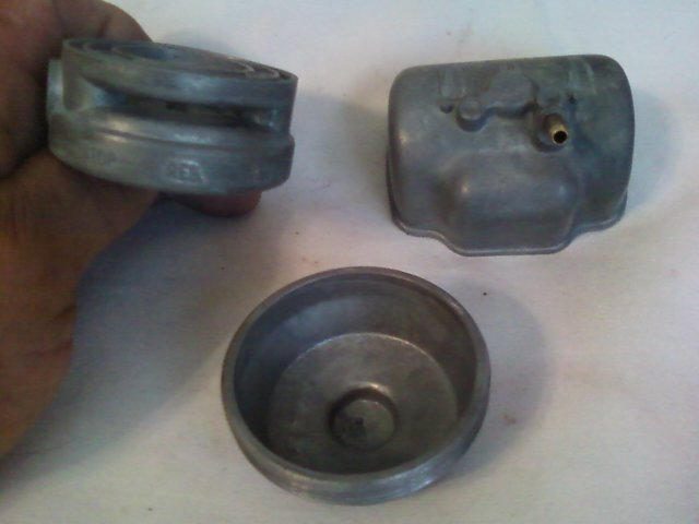

I soaked these parts over night in straight pine-Sol and this morning I rinsed them off and wiped them down .
All the crud came off and they look brand new.
I am very pleased with the results.
