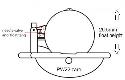

So, assuming the float height is adjusted correctly (carb off, laid on its side, pic 1 below) and you have a healthy, fully charged battery:
