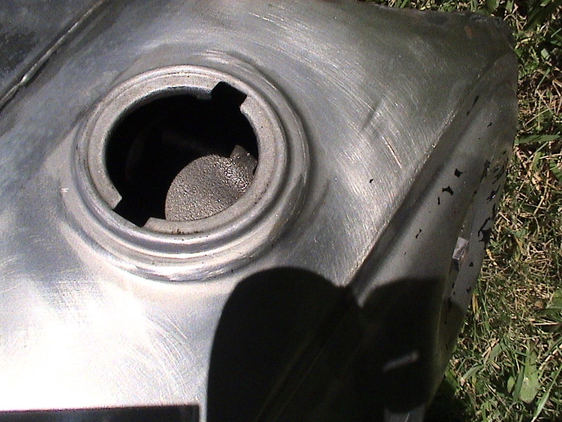

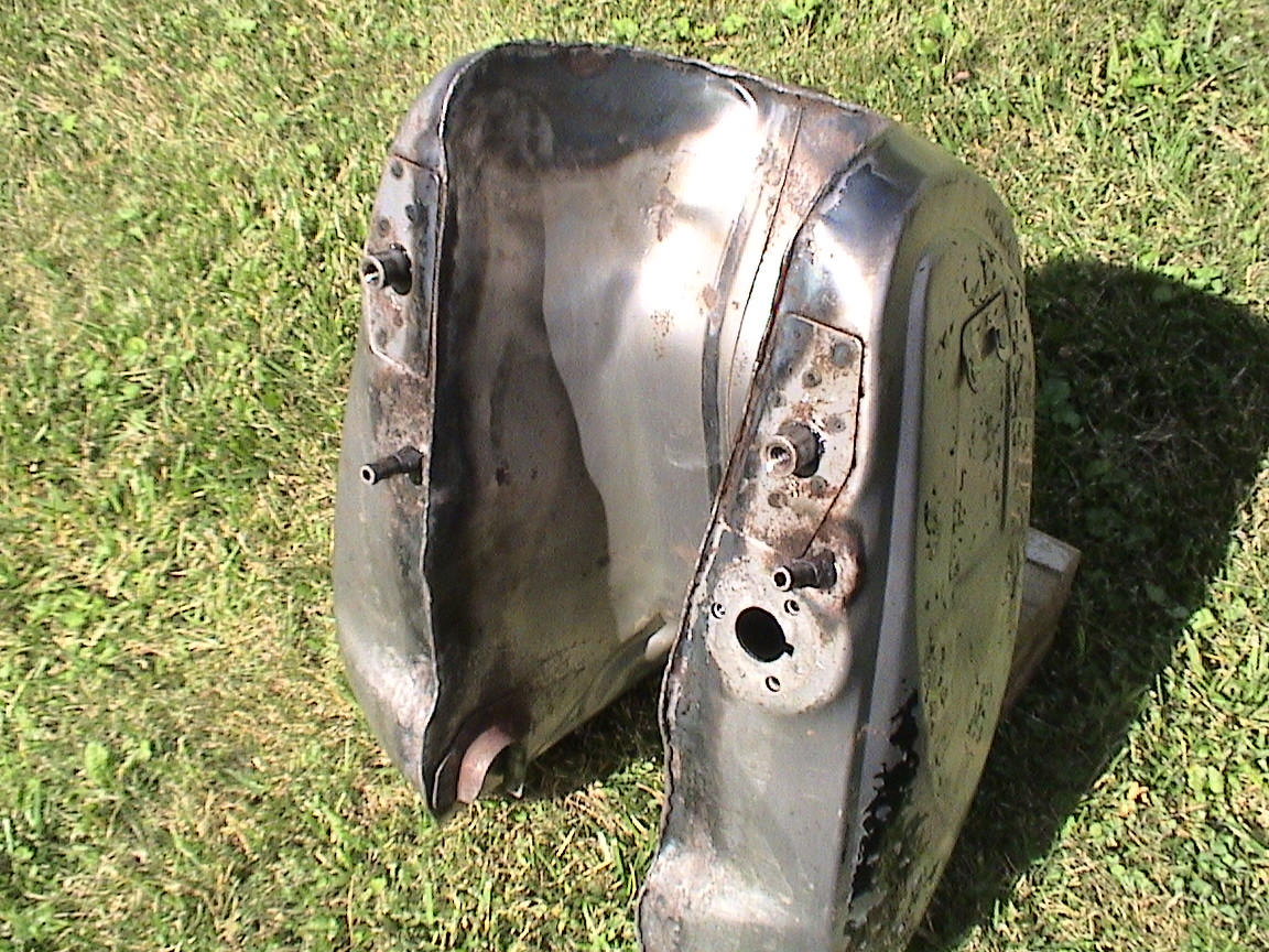

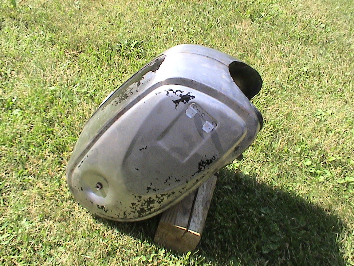

I hate to admit defeat, but just got tired of it, so I took it to my local radiator shop and asked them if they could do anything with it.
They said they didn't think so, but they would try, and if it didn't work they wouldn't charge me.
Here's the result.....should have done this first!
Post by brewsky » Thu Jun 24, 2010 11:39 am
Forgot to add ...cost was $30.00, for dipping, steam cleaning the inside and coating inside with wd-40
When I asked what kind of acid they used, he said he didn't know but it was a white powder he mixed up?

Looks great. Well worth the $30. Not gonna coat it?
Post by brewsky » Thu Jun 24, 2010 2:17 pm
Spargett wrote:Looks great. Well worth the $30. Not gonna coat it?
No coating planned.
I've seen too many failures with Kreem.
I've heard good things about the POR, but don't trust myself enough to do it correctly.
I figure if I keep fresh gas in it its not necessary.
The tanks come from the factory without a coating so I figure it's overkill anyway.
I've been using a rusty tank for a couple of years now with no problems.
I added an extra inline filter just in case, but haven't seen anything get into the carb at all (or the clear filter either for that matter).
