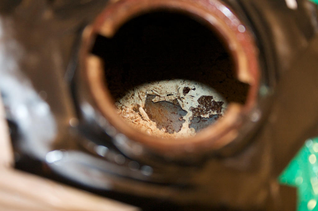

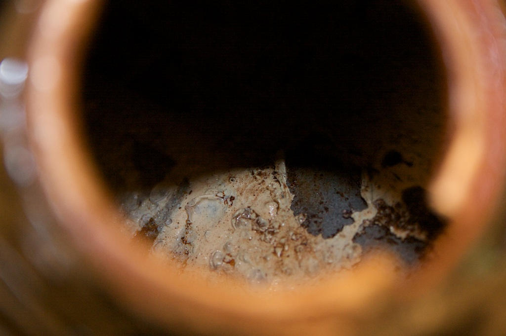

So I've been repairing my tank (removing shoddy kreem job, treating rust, etc.). I purchased the Por-15 repair kit from from Classic Honda Restoration. The POR-15 stripper, which was recommend by Classic Honda Restoration was pretty much worthless and a waste of money and time. I followed the directions to a "T". I tried sticking a wire brush down in there to see how loose the pieces of Kreem were. They're on there pretty solid still.
I was wondering what other options I have to stripping this sealant in here. I just want it out so I can get the rust out effectively and do a better job of re-sealing the tank than the last guy. I've think I've heard muriatic acid, acetone, and MEK? as something people have used, but I clearly need something really effective. I have the Metal Ready™ and an assortment of BB's, slingshot ammo, and bolts ready to shake to all hell once I get this sealant out.
Thanks in advance.
P.S. The tank sealer came with a 4" foam brush. Do they really expect you to stick that through the gas cap hole and paint the inside of a tank with 4"?
Majority of Kreem sealant remains.

I picked up two quarts of MEK, which I've heard works pretty well for getting Kreem out. And I can confirm, that after about a week of soaking with regular shaking, its pretty much all out. I had a slight spill which cause some damage to the tank's paint. But I planned on repainting the shoddy job someone else did anyway.
Unfortunately the gas cap isn't faring so well amidst the chemical baths this thing has been through. Especially the Kreem liner, which turned into a thin soup after the week of bathing in MEK. When it made contact with the cap it dried into a thin plastic-y mess all over the poor cap and it's gasket.
I've gotta say what a pain this has been trying to remove this stuff and all the rust underneath. Whoever did the "job" before me should be ashamed of themselves.
