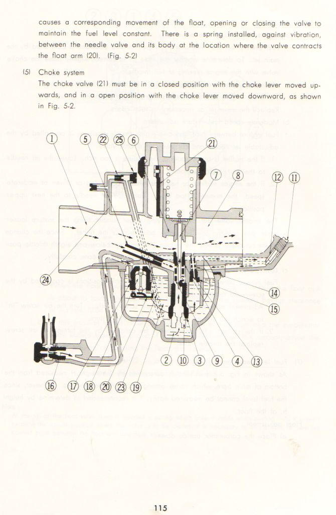

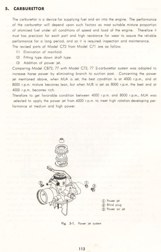

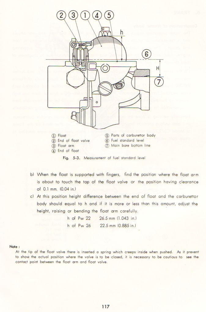

...and who don't have the original Japanese shop manual (no, in English!):
NB: Power jet carbs were only fitted to the twin carb 247cc derivatives.
