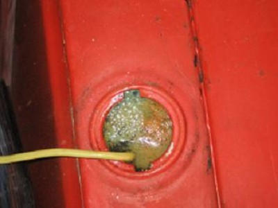

This is how I remove rust from tanks.
Supplies: 10amp battery charger, Bolt (zinc or steel), 3ft. 10 gauge wire, water, Sodium Carbonate (Pool/Spa chemical PH+).
Mix 1/4 cup sodium carbonate for every 2 gallons water. Fill tank all the way full. Strip both ends of 10 gauge wire and twist one end on bolt. Attach other end of wire to pos. lead of batt. charger. Place bolt in tank suspended by wire. Clamp Ground lead to good ground on fuel tank. Plug in charger. It will bubble and start to have a crud foam form. Every couple of hours, remove bolt and rinse crud away, also pour more solution in tank to wash top crud out. Do this until no more crud foam appears (one to two days). Drain and rinse tank. Blow dry and put handful of 1/4 nuts in tank and shake (will Knock black oxide off). Blow out with comperssed air and you are good to go.
This process only eats rust not steel. It converts rust to black oxide. The surface left behind is rust resistent, and does not need coating (unless there is a leak). Acids will leave a surface that will rust quickly. Try it, it worked great for me.
