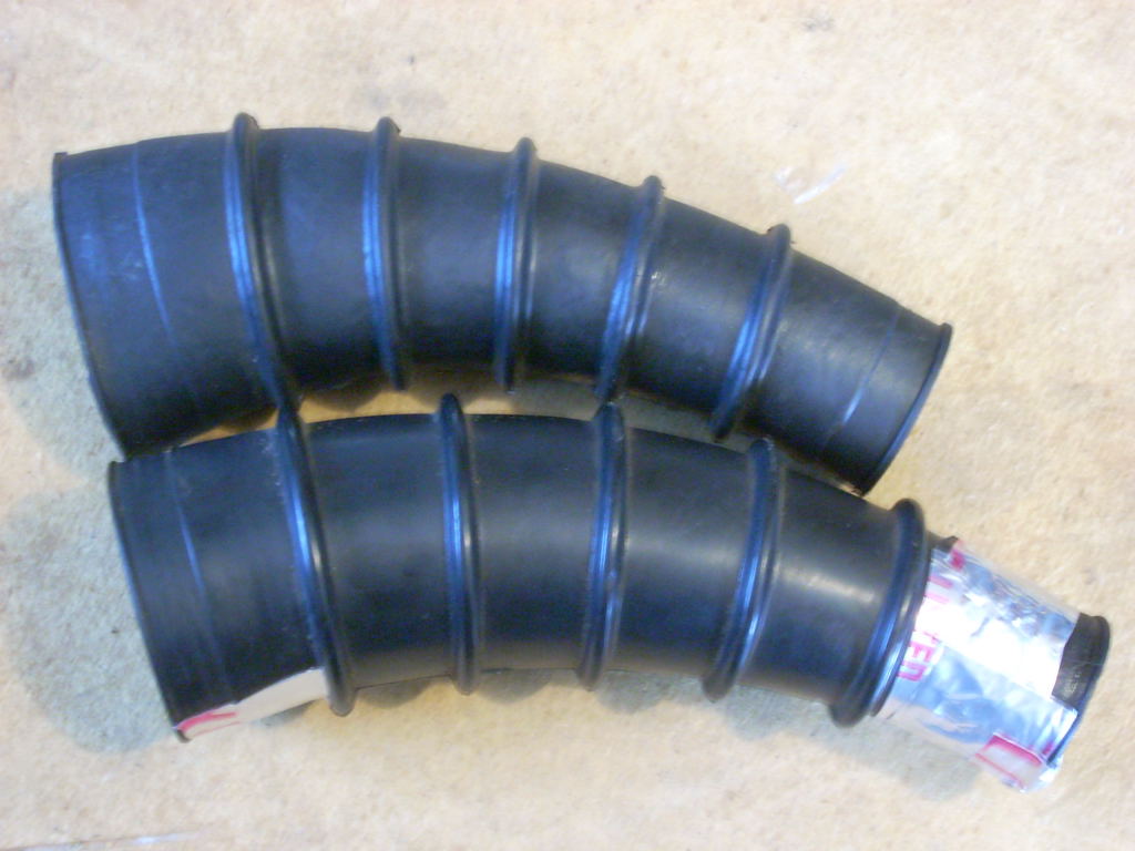

Kigsby wrote:I have a 1962 Dream 305 and I just bought a new rubber air filter hose because the one I had was cracked and split. The new one doesn't fit. It's too short by about a half inch. I don't know if they sent the wrong part - or did the '62's use one from a different model? I'm going to return it, but I'm not sure what to order. I saw this on ebay. Anyone use one of these filters that attach directly to the carb?

I measured them side by side and just by looking at them I could tell it was shorter. I got the tape measure out and the new one measured 8 1/2 inches and the old one measured 9 1/4. See the pic attached. It's mounted correctly on the carb and the filter. The long pin is going straight through the center of the filter, so I can't move it much to reach the tube.

Wow - that's way too short. Your original post said 1/2" thus my other questions. I'd call Tim Monday and see what's up. ....lm might be right - the CA92/95 have similar setups. I'd try to find an OEM part or just use your old one with some electrical tape. We won't tell...

I sent Tim an email with the pic showing the size difference. I'll let you know what he says!
