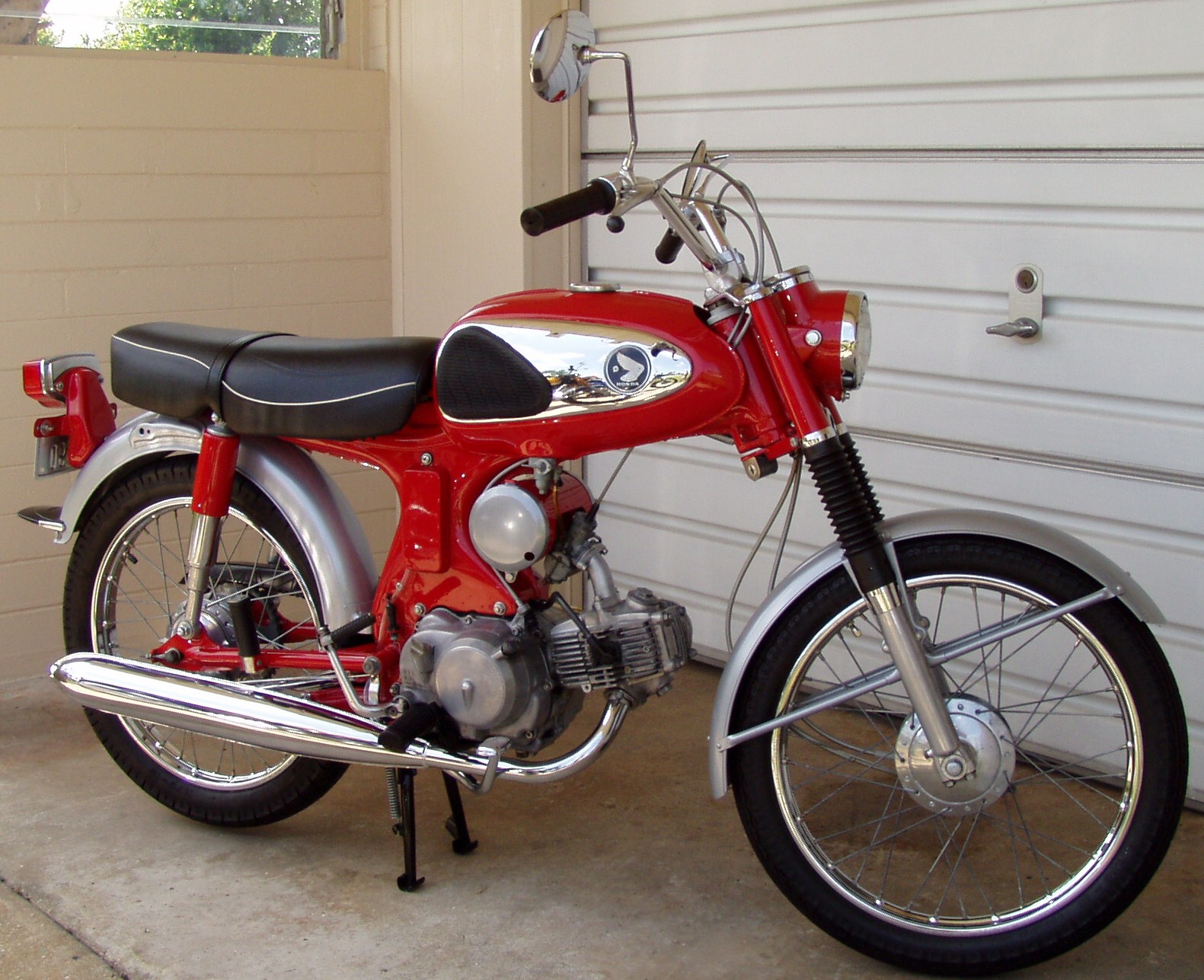

Hi, I have a Super 90 that i restored in 2001...it had the same issue as yours with the needle jet holder bent. I had a hell of a time finding one looking in MC salvage yards and when I found one it was also twisted and bent I don't know what people were doing to them! I needed a perfect muffler and another gas tank and found a bike on ebay that had been semi-restored so I bouth it for the parts/spare engine...the carb was perfect so that needle jet holder issue was resolved and he had a NOS gas tank! in a box that came along with it. Mine is the later frame, 67, that has a different tank mount as well as a different rear fender mount than the early ones. After assembling most of the bike I decided to have the spare engine top end rebuilt and put it in the restored frame....the surprise came when I got it running and it wouldnt shift into 2nd gear, would just go in first and then neutral. I asked a mechanic friend to help me and we pulled the right side cover and I tried to shift it. he started laughing and said the shift mechanism was as far as it would go up so try down!. well it has a japanses domestic transmission pattern of neutral on top and 4 down! shifted fine once I got the hang of it. just like the 64-66 yamaha 100 twins that had 4 down transmissions,. I too had an s90 in 1966 before I turned 15..lloved that bike and restored this one to look the same. davidsilverspares.com in england hasalot of s90 parts. hondanuts.com in new york have parts too as well as westernhillshonda.com in cleveland. PM me if you run into trouble as I have some experience with s90's. Tim

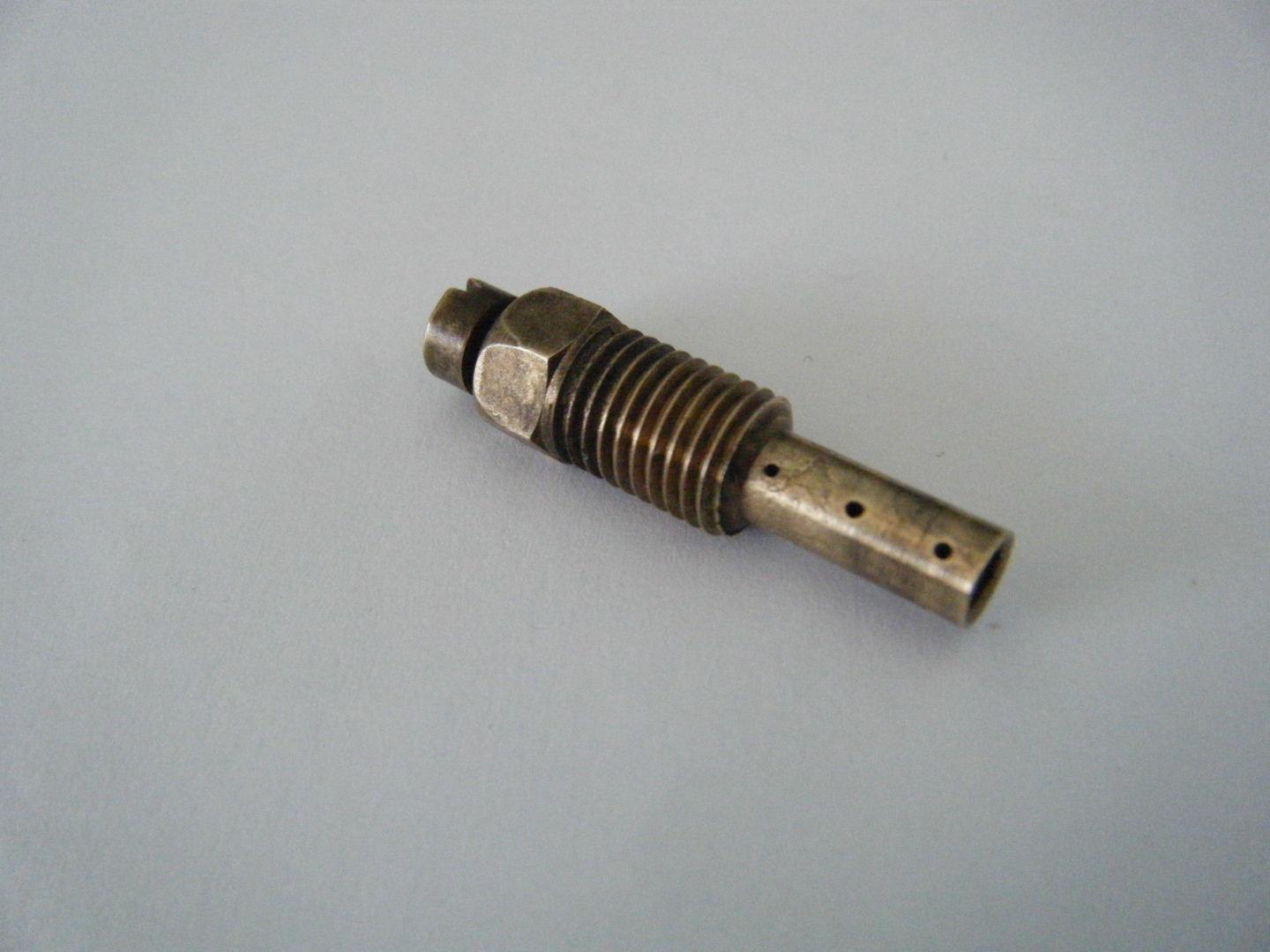

Chiboy, Here is the part I emailed you about.
I think that I have a pair. 125 jet size. Scram64
No. You are correct. Needle jet in those carbs is a simple stepped piece of brass. Almost all slide carbs are 2.60mm needle jets but the heights vary from one to another.chiboy002 wrote:yeah i pulled it out and was like how in the hell. They must of kept going even if it got hard cause its done.
My only concern is cause the needle jet is probably crushed or indented or something and thats why i wanna replace it. It doesn't seem ovaled but you can tell there is some slight damage to the mating surface or the surface that faces the holder, since it prolly smashed against that.
Needle Jets have cross holes? I thought it was just a small cylindrical jet with the passage in the middle
It's that jet holder/emulsion tube that has cross drilled bleed holes.
You could probably drill the bleed holes out with a 1/16" drill bit and clean up the top face and drill it through with a 7/64" drill bit until you find a replacement.
