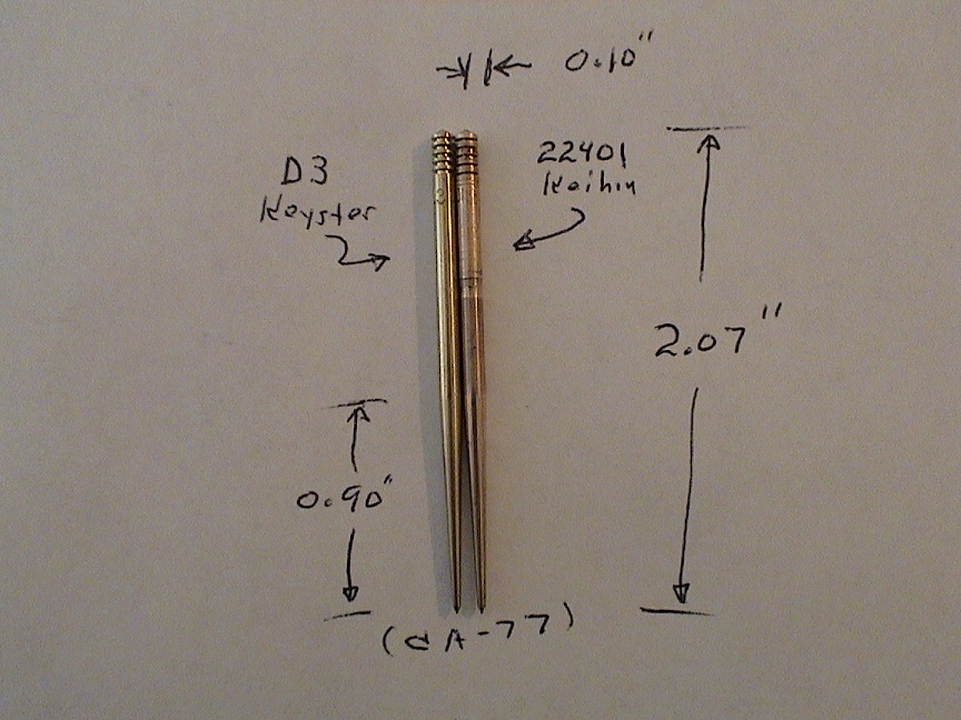

Post by brewsky » Mon Aug 31, 2015 4:37 am
Here are the correct needles/measurements:
Keihin ....marked K22401 (best)
or
Keyster ..marked D3
needle clip in middle slot
float at 26.5mm (measured from notch in side of carb body)

Post by brewsky » Mon Aug 31, 2015 6:28 am
DianneB wrote:Thanks!
No problem!
My dream went through the same blubbery rich conditions in the beginning.
Turned out to be too large jets supplied in the Keyster kit, as well as ME setting the float to the WRONG 22.5 mm (superhawk) spec.
