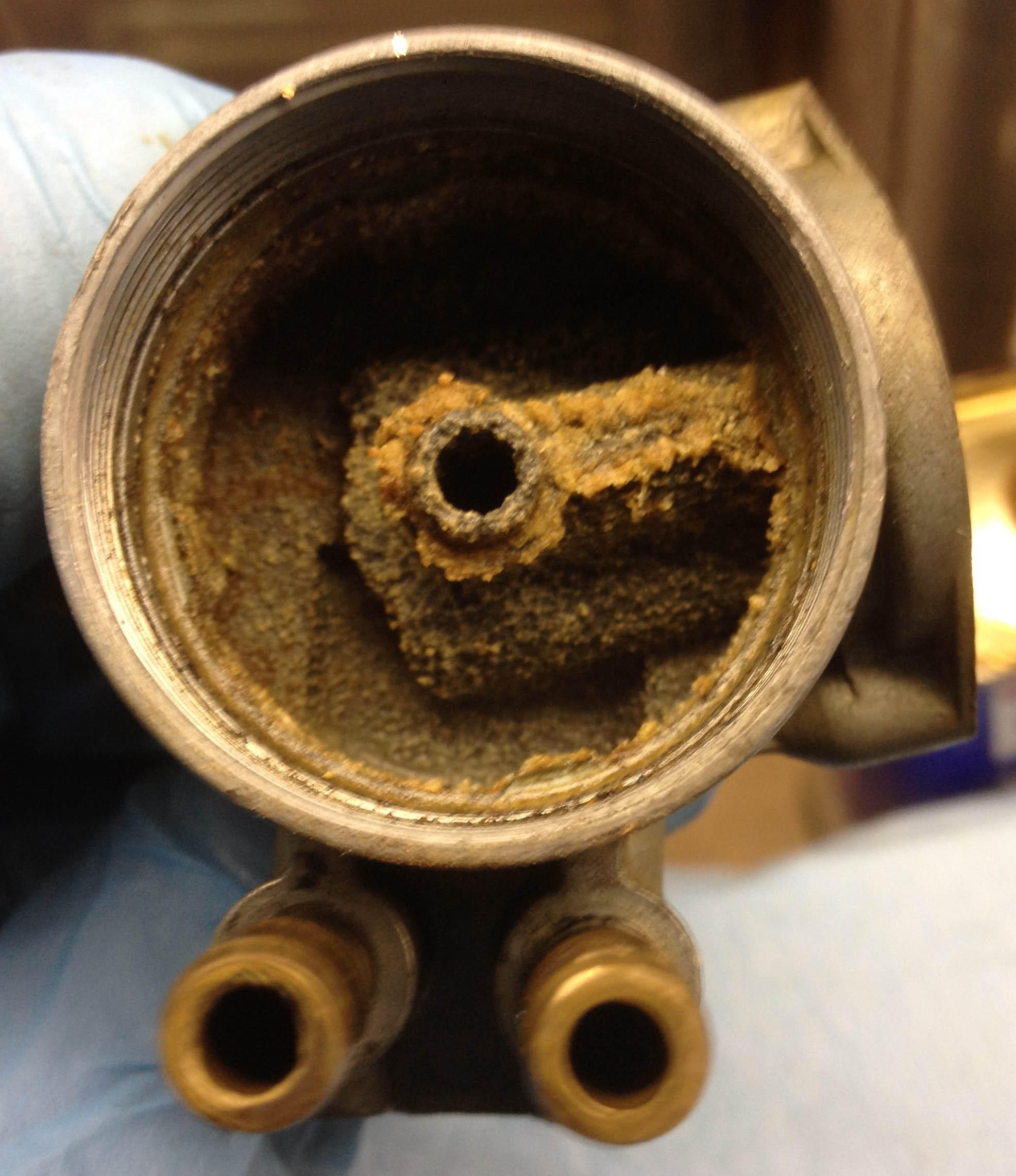

I am now an expert at petcock rebuilding. An O-ring from the local hardware store plumbing dept. or (16958-268-010), a fuel gasket(16955-268-020), and a new screen (16957-268-010) paper clips, awls scotchbrite pads and carb cleaner. Wear gloves the carb cleaner will tear the skin off your fingers and don't breathe it in.
This is what sitting fuel does

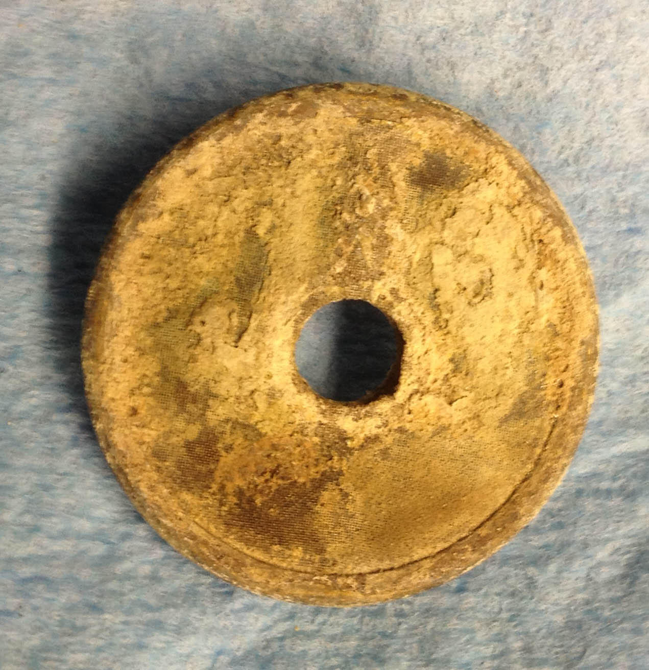

Post by volare71 » Mon Jan 14, 2013 11:18 pm
Here is the screen. Might as well lay in a stock of them
This is what sitting with fuel will do
