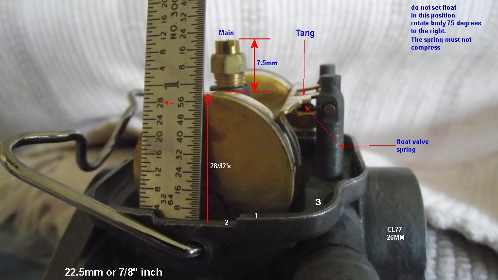

but setting up the dang float level , now that is black science, done 100s ,more for sure. car and bikes.
but not on CL77
i ask for help and get , cryptic, you are wrongs. etc
what do you think?
I have many old honda books that show other bikes other ways. (1 of 3)
cheers
PS the worst books show a carb as a gray blob, no detail then a equally gray blob
caliper in a Japanese mans hand against the bowl. ( you look and go , gee, what a lousy drawing)
my best bikes i can run a clear line down to the drain cock and get real levels.
some carbs they do say where the real level will be...
and as you know it is critical. as is that emulsion mix business. (etc)
i see huge errors ,1,2,3 choices. Thanks for all help!
