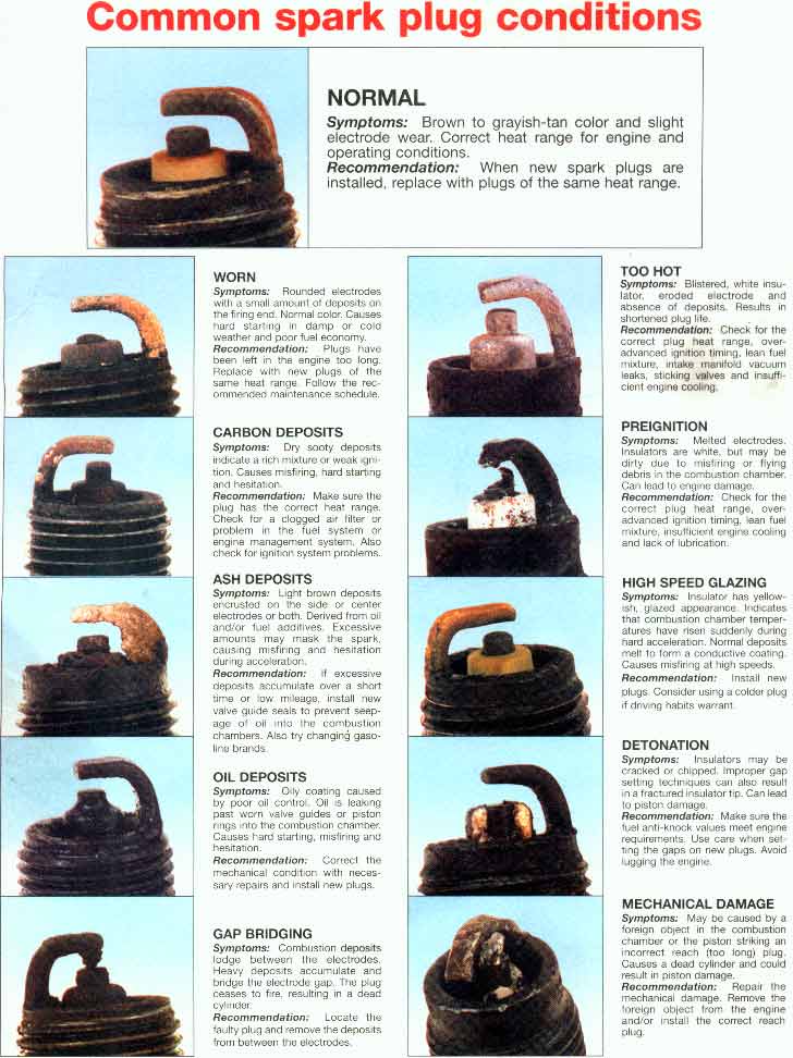

davomoto wrote:They look a touch lean to me as well. Are you doing throttle chop readings, or just a generic reading?
What I usually do for a street bike is sort of a combination Davo - on cleaned plugs, I do about a 30 min ride moving through the entire RPM range then make a full power run through the gears and letting it rev up before shutting off and coasting home.
Do you think the chop technique gives a better overall reading or is it more for a top end snap-shot?
I read plugs a little different Steve;
- the circular base of the threaded body shows low speed (<1/4 throttle)
- the ground arm (strap) and electrode tip show top end (>3/4 throttle)
- the electrode insulator shows overall burn in the combustion chamber
Not saying that's necessarily correct, it's just the way I've always done it.
Anyone out there have a pair of 145 main jets they'd like to sell?
Thanks, Chuck

Chuck, that's an interesting method of 'plug diagnosis'. When the ol' girl is up & running I'll give that a go with a new pair of plugs (I have an abundance of D8HAs & D8HSs due to a purchasing oversight!).Hotshoe wrote: I read plugs a little different Steve;
Not saying that's necessarily correct, it's just the way I've always done it.......
But, I have to say, I've never seen the plug body anything other than considerably darker than the electrodes -- Bosch surface-discharge plugs notwithstanding. The logical part of my grey matter tells me that it's because of the mass difference, whereby the body doesn't reach the temp of the electrodes and insulator and, therefore, takes no part in the creating of the spark or combustion process.
Thanks Davo, I've never heard of using the chop method for anything but WFO... that opens up a whole new carb tuning technique for me.
The heat sink effect on the plug body makes sense as far as why it's darker Steve. For general plug reading, I've always thought that an excessively sooty base ring indicated a rich low end that can be adjusted somewhat with the carb air screw.
I've always done something similar. But I was taught to actually kill the engine with the clutch (stall it) to get a good reading. I don't know if that's necessary, it's just what I was taught.davomoto wrote:It's basicall whatever throttle opening you hold for 15-20 seconds, pull in the clutch, and kill the engine. It can be done at idle, 1/4, 1/2, 3/4 and wfo.
