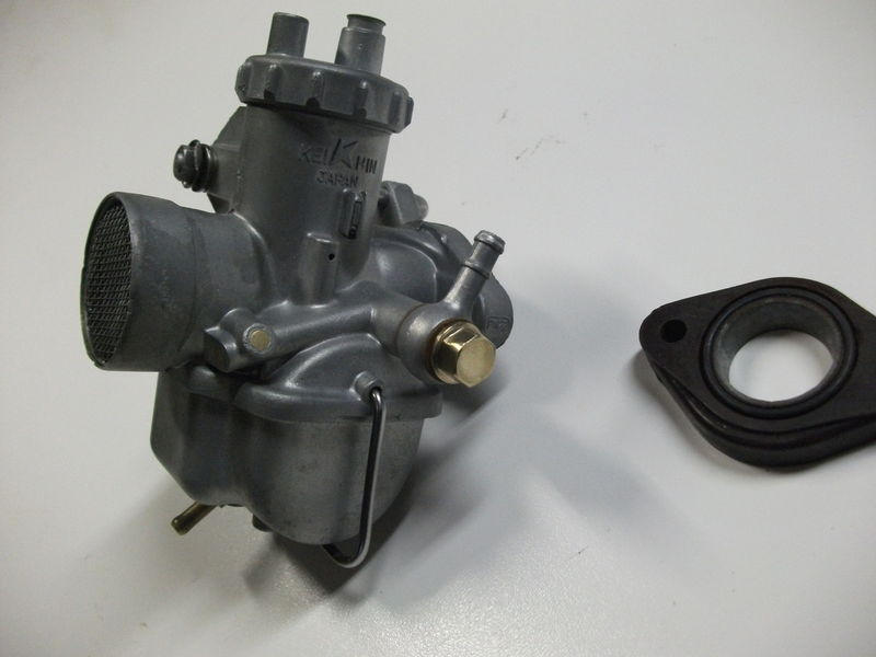

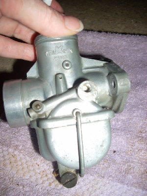

OK...last question I promise. I don't want to beat this horse to death, but I'm just curious. I was just looking at the one on ebay again and comparing it to mine. Mine looks like it has a round float bowl bottom and the one on ebay looks more oval. Is that just my bad eyesight or is that another difference between carbs?
