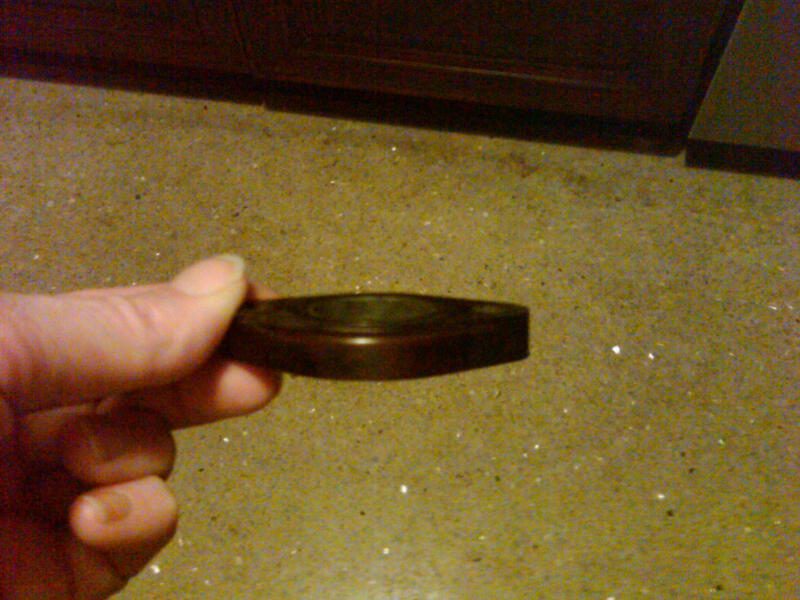

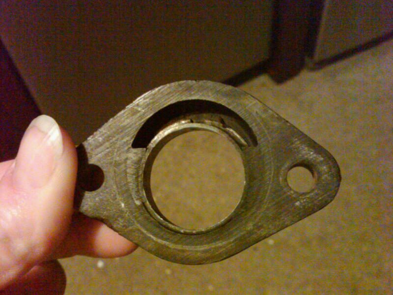

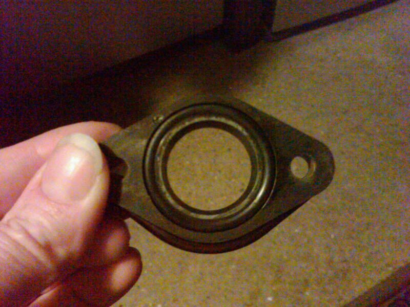

Post by Kigsby » Mon Jan 02, 2012 7:58 pm
I took it off and tried to clean it a little. Looks like it may have a slight reddish/brown tint to it. Took some pics - Is this what you were talking about or am I missing a part? I don't remember now which side goes where - does the side with the cut out (last picture) go on the head side or the carb side? Is that cut out even supposed to be cut out or is it worn and need to be replaced? Thanks for your help!

Post by LOUD MOUSE » Mon Jan 02, 2012 8:03 pm
That is the part and the "O" ring goes to the HEAD.
Cut out area Down. . ........lm
