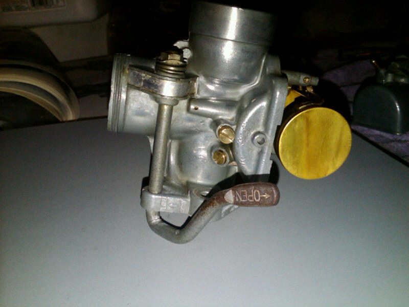

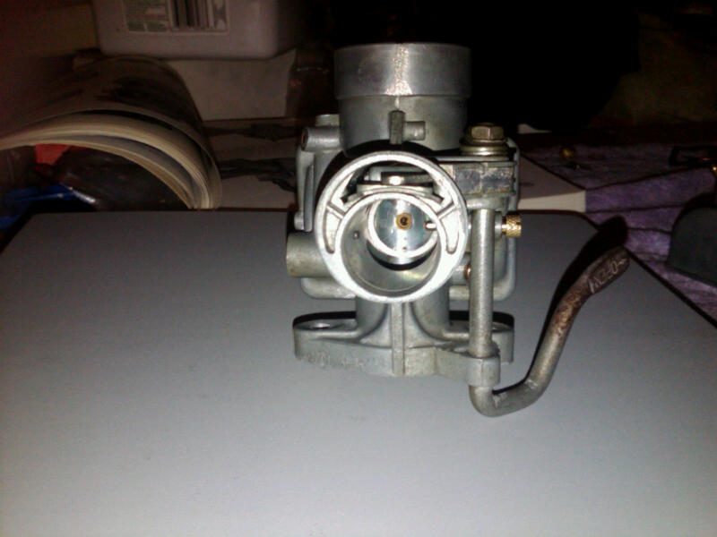

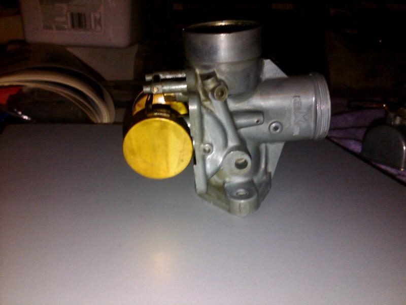

Well I took the carb out for cleaning and thought I would post some pics to see if they were the correct carbs for a '62 Dream 305. That may solve the mystery as to why the new air tube didn't fit. So.....does it look like the correct carb?
