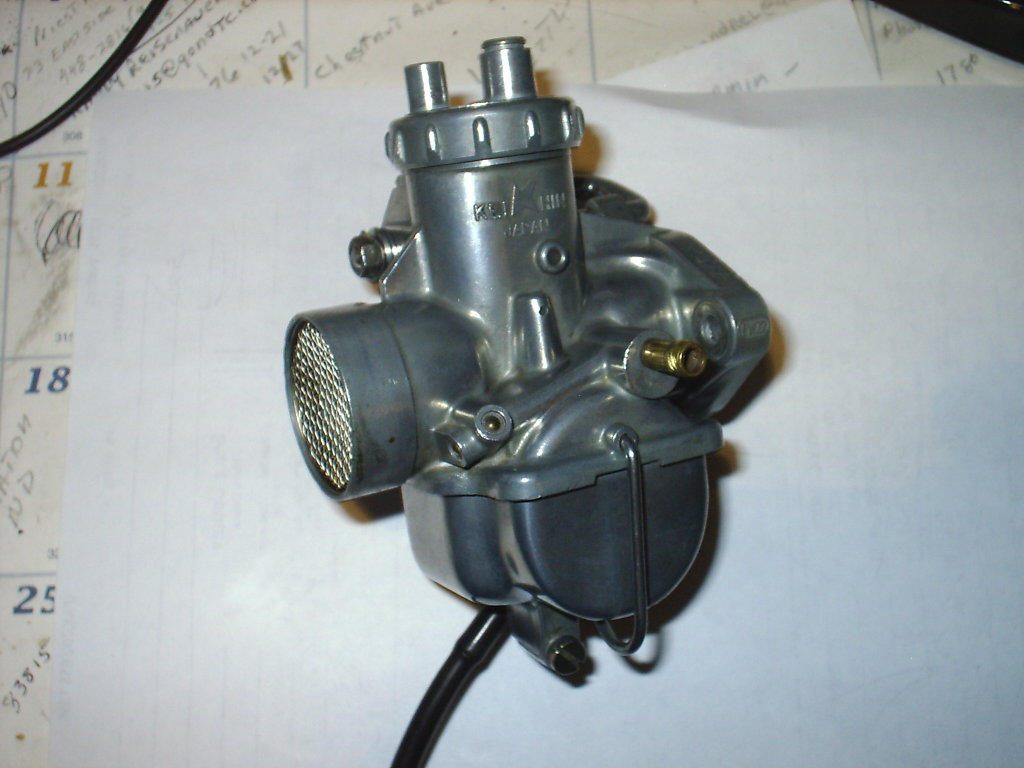

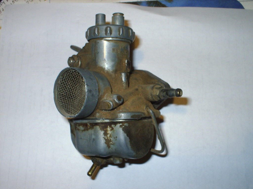

There's a "K" after my C77B K if that means anything. My engine # is CA77E 21345 and the frame is 23244. It's registered as a '63 but I've been told it's a '62. I'll wait for LM to hopefully give his opinion. I'd like to have the correct carb on the bike (whichever one that turns out to be!) Thank you SO much Brewsky for all your help with this. I was so afraid to even touch my carb, now I'm throwing it on and off in 10 minutes. I've learned alot.

Sure does look like HONDA did issue a different fuel inlet DREAM carb.
I've had in hand many DREAM carbs and never one like the shinny one.
My guess is it may be a after production carb.
Ya never do know it all.
Just what ya know to that time. ......lm

ironangel wrote:Note that in the above pictures the dirty carb has the threaded nipple and the shinny carb has the pressed in nipple,
