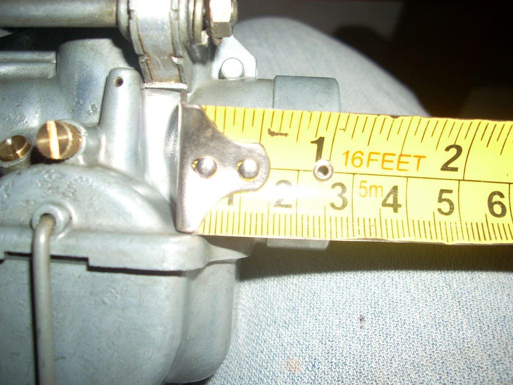

OK....the 22 mm Dream (CA) carb (late square type) measures 3.45" front to back.
The 22 mm dimension is the inside diameter of the bore at the engine end of the carb.
The center-center of the mounting studs is aprox 48mm.

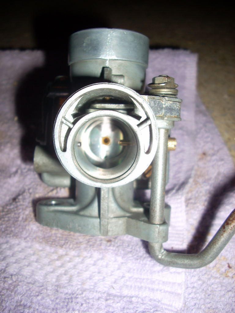

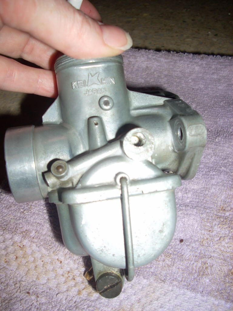

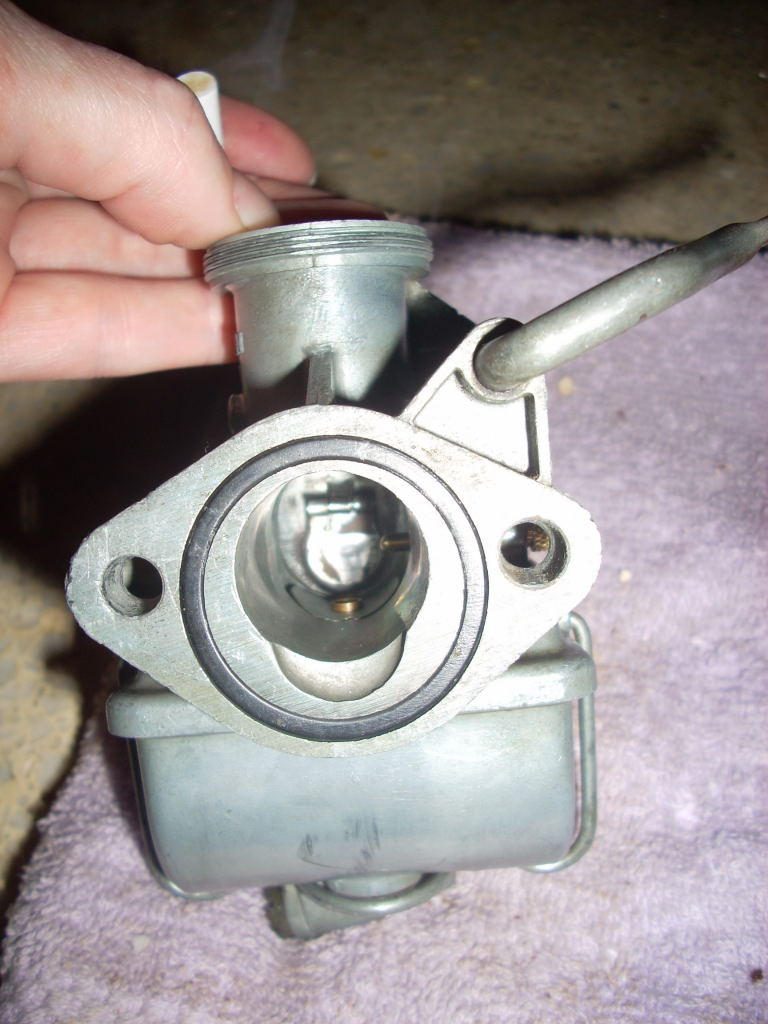

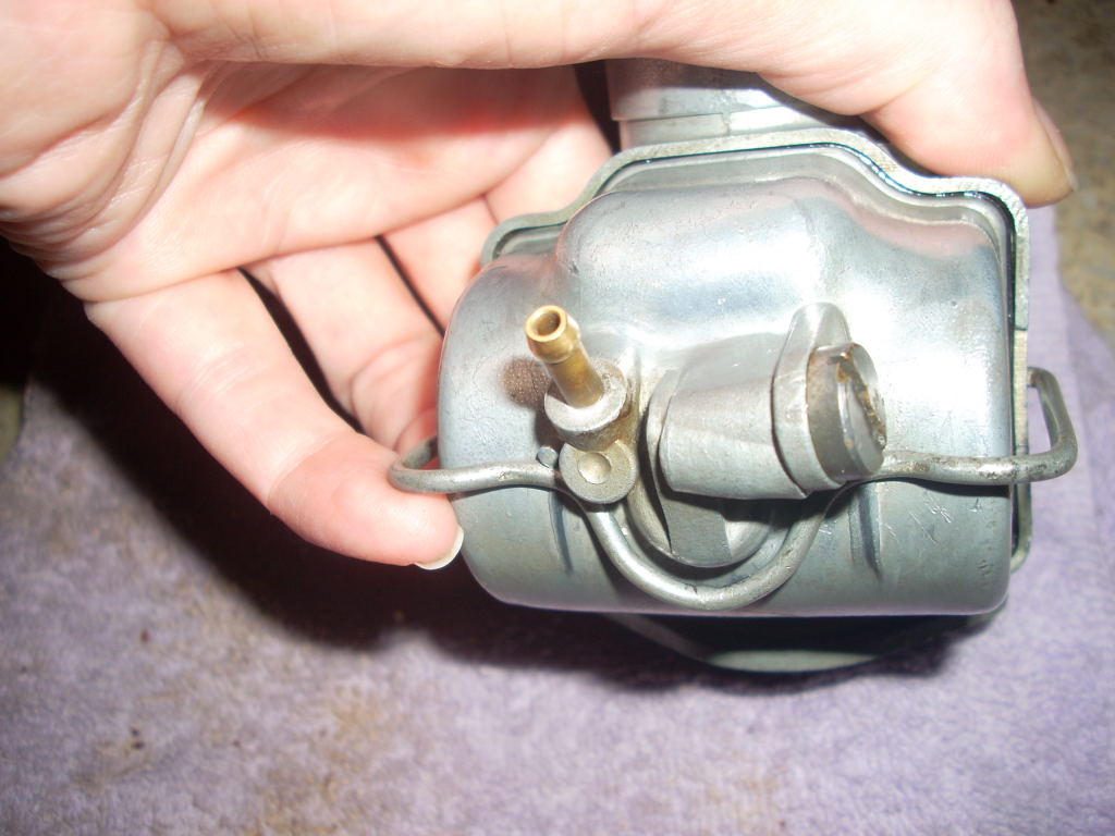

OK....I took off the carb and it has a stamp that says C77B and PW22. The jets are 120 and 35. Pics attached. So I guess it's not an upgrade to a PW26 (which I guess is good so I don't have to worry about what else was "upgraded"). The snout measures about an inch. Are the jets correct? Should I work with it or order the correct carb for a Dream?
oops my mistake!!! There's not that much difference in length.
However....the carb size and jet sizes are correct for a Dream, so it might not be all that bad.
What is the number stamped on the needle? It should read 22401 for the dream.
