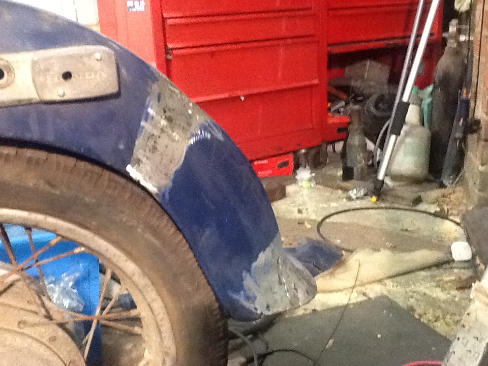

Thanks Steve, I'm pleased with the end result, I wanted to do all the rebuild myself. The mudguards had been sawn off so I fabricated the flared ends so they are probably not 100%. Like wise, the carb cover, again I made this using photos and the fit of the frame. The chrome on the rear shocks was done professionally but the rest I did using a chroming kit I bought off the Internet. The colour originally was dark blue but I felt light blue suited the shape of the bike. It was just a basic paint so was easy to spray and only cost£16 a litre. I'll fit the right silencers if they come available.
