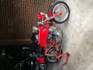

I have finally finished the restoration of my 1963 CB72 cafe racer
I have fitted Amal concentric carbs, and while I can achieve a good smooth tickover and easy starting, under load the the running is poor, with misfiring.
I am fairly certain that it is a fuelling problem, and know that I need to set up the jets for the different throttle openings, but was wondering if anyone had experience of the best set up, to save me too much experimenting!
Any advice much appreciated
Many thanks
