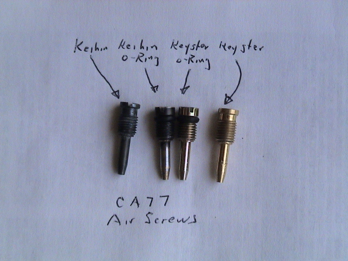

						Some carbs had 0-ring screws and some didn't.Wetwilly wrote:Wonderful!
These are the ideas I needed.
- I checked the o-ring at the air bypass screw....it was missing! I think I may be on to something but I have a bit of a dilemma. My Clymer manual shows the o-ring between the spring and the threads of the screw. This doesn't seem to work. There is a groove just under the head of the screw and I assumed that must be where the o-ring went. Tried the bike with the new o-ring and no difference. I'm not quite sold that the o-ring is installed correctly though. Do you have a picture of an air bypass screw with the proper position of the o-ring?

The ones that did had a deep groove just under the head, the others just a shallow "groove".
Attached pic shows both types, with the ones shown with no o-rings don't get one.
				- DSC00615.JPG (456.69 KiB) Viewed 2250 times
						Thank you for the pictures brewsky. I have the shallow groove kind so I guess I don't need the o-ring.
